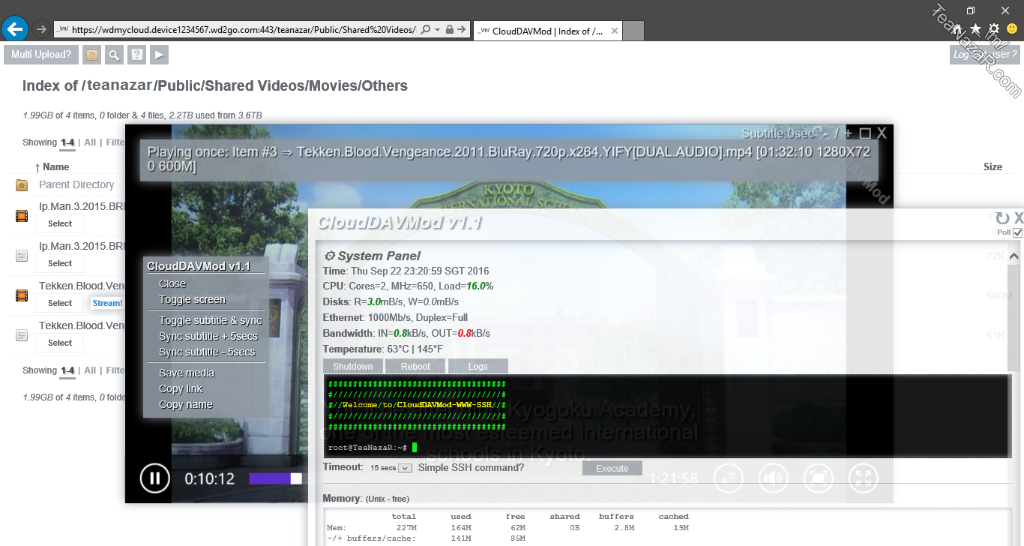

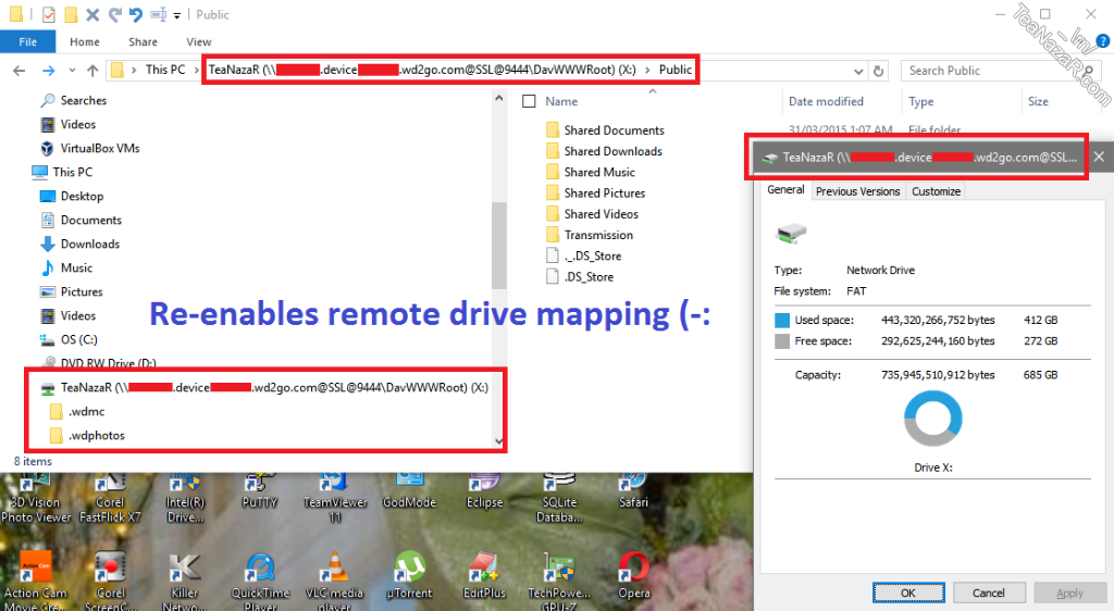

This is my original release (-: On top of re-enabling the remote drive mapping which WD has unexpectedly removed from MyCloud, this mod provides a basic WebDAV webGUI based file manager that integrates seamlessly beneath the existing WD MyCloud Dashboard. No additional backend daemons. Fast, secure, light-weight yet powerful and easy to use (-:
Features:-
  • Completely bypass MyCloud.com account login. It’s directly between you and your MyCloud NAS. With a personal DDNS 3rd party service, CloudDAVMod should work well even behind strict corporate firewalls or computers that blocks cloud services.
  • Unlimited filesize transfers where the usual mapped drives has a platform specific WebDAV filesize limit.
  • Common file/folder functions such as copy/paste/move/delete/rename/mkdir and advanced search/properties/export with keyboard shortcuts to these functions.
  • Multiple uploads via single mass selection OR Drag&Drop files from the desktop directly into a supported HTML5 browser.
  • HTML5 image previewer with navigation/zoom/pan/rotate support, HTML5 audio streamer with matching filename M3U playlist track order and track title support and HTML5 video streamer with matching filename SRT subtitles support.
  • System panel for MyCloud Dashboard admins; CPU/RAM/Disk/Network/Process usage, S.M.A.R.T. temperature, run simple WWW-SSH commands with simple color support, remote reboot/shutdown and download system logs.
  • MyCloud file/folder auto expiring URL links sharing with captcha and password protected zip. Safely share your selected files and/or folders with anyone!
This is CloudDAVMod v1.0 and v1.1 for WDMyCloud V4 OS3 Firmware. For features, setups and details, refer to CloudDAVMod v1.1 for WD My Cloud firmware V4 | TeaNazaR.com
