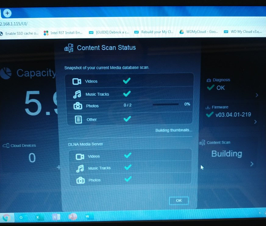

EDIT: I followed all of your instructions and methods as well as Fox’s guide. The only problem I ran into is when I tried to “sudo touch /mnt/hdd/etc/.fresh_install”. I got a message stating touch: cannot touch. “Structure needs cleaning”. I have no idea what that means or what to do for that. I continued to the next step with the umount procedure. I have been able to do the touch procedure before and it worked fine, so I don’t know what is different this time around. I did install ubuntu on a spare hard drive and used a different computer so I dont know if that did anything or not. I have the drive plugged in now and will update in about 15 minutes to tell you whats going on. In the meantime, when transferring files to the sda5 and sda6 is it normal to show 2048+0 records in/out (100MB, 95MB)? I dont know what the 100 and 95 is. It seems to me like out of 100MB only 95MB copied? For sda6 and 7 it shows (1.0MB, 1.0MB). For the md0 it shows (2.0GB, 1.9GiB).

Correct. I unbrick with the v3.x. Then use the firmware from the My Cloud site and manually update the firmeware through the My Cloud Dashboard interface. Not sure if you can jump from the intial v3.x to the very latest v4.x firmware as I normally do a intermediate early v4.x firmware first. See my post above where I explain this.
normally I just pull the power on the external drive adapter the My Cloud hard drive is connected to when performing an unbrick. If one is using a Linux boot disc/USB flash drive they may need to run the apt-get update + mdadm install command again each time they reboot their computer.
It does take a while, not sure how long exactly for the initial boot post unbrick. As indicated before though, one may have to perform the unbrick procedure more than once to get it to stick. It’s possible one may have missed a step.

UPDATE: after the last unsuccessful flash using the script provided - I used the terminal to manually extract an earlier firmware “original_v03.04.01-230.tar.gz” to the sda partitions. I had to manually set raid 1 on and raid 2 on. I restarted the computer then did the mdadm --stop /dev/md* command. I skipped the mdadm -A /dev/md0 /dev/sda1 /dev/sda2 command and continued. I was able to do step 13 manually by closing the terminal window after transferring the kernel.img, config.img, and rootfs.img and opening an new terminal window and doing the mkdir /mnt/hdd and mount /dev/md0 /mnt/hdd and the touch and umount commands. This time it actually worked.
I plugged the drive in, and although it has been a half an hour there is no blue light. The progress made however is that both the mycloud LAN LED’s are now both on and both GREEN!
I think this is progress because now the LAN is both illuminated meaning it has a connection and been assigned an address. I am not able to access the device over lan howerver.
At least I feel this is starting to show some hope. Perhaps I need to just let it sit for a few hours before turning blue? Or should I attempt a soft 4 sec reset? I do not want to unplug it directly to do a 40 sec reset unless someone advises me to.
Thank you all for your help!
One suggestion. Per the directions cpt_paranoia posted in the Clone NAS hard drive to SSD thread, make sure the drive you are attempting to use does not have any partitions. And also run a mdadm --stop /dev/md* as well before you run that script or before removing partitions on the drive.
Sometimes what will happen if one doesn’t remove the existing My Cloud partitions, in particular the two RAID partitions (md0) is when one attaches that drive to their computer Linux may automatically mount the two RAID partitions as md127 and possibly md126 (at least that’s what I’ve seen it do numerous times on my end).
Hey Bennor! I did exactly what you said (stopped dev/md0 and then ran gdisk then reboot computer) but the script still throws those errors I posted in my earlier threat. I manually did everything without using the script and got no errors with my code, but the darn thing will still not turn blue. The light is solid yellow and now I only have a green LED on the upper LAN port. Is it possible my mycloud motherboard is bad? Or perhaps I am grossly neglecting something obvious? Perhaps with all of your experience maybe you wouldn’t mind testing my drive in one of your enclosures and seeing if you can get it to work?
UPDATE: I was going to reflash the drive one more time because after an hour or so the light was still yellow. But before that, I thought to myself I would just power cycle the drive. I unplugged and plugged the power back in and heard the drive start up and start seeking. The light then turned red. I could access the dashboard FINALLY!!! I did as you had said and immediately went to do a Quick Restore. The dashboard still is showing the drive doing a restore and the light is yellow, but I am hearing clicking and data sounds - so that is good (i think). I will leave it plugged in overnight and report back tomorrow if it actually finished the quick restore!! Thanks you guys!
UPDATE 2: The drive finally did its restore and I have full access! Updating to the v04.01.02-417 firmware now then will update to latest release! I will let you know how it goes!
UPDATE 3: I am getting errors when trying to update the firmware. The device will not allow me to download the latest firmware from the dashboard nor will it let me upload a file from my desktop. Any ideas?

Here is what the dashboard first showed when I unbricked the drive - you can see it says 1.5TB:
Then after I ran the Quick Restore and tried to update the firmware but failed due to errors (there were errors when just trying to click through dashboard tabs - one of which wouldn’t let me register users). I remember one particular error was saying to check network connectivity but both lights on LAN were flashing on the mycloud and I was already accessing the mycloud via a computer on the network.
So I decided to use a spare router I had lying around to ONLY connect my laptop and the mycloud to it. I did this in the attempt to flash a firmware to the drive without the drive knowing (via internet connectivity) there was a more recent firmware update. Like you said, you didn’t know if you could go directly from the v03 firmware all the way to the newest. I was going to go to V4 first firmware then update to the one you had mentioned and then update to the newest.
As I said before though now I am at a solid red light and neither the 4 sec or 40 second reset are doing anything to the drive - the light on the drive does not flash to indicate it is recognizing the reset button being held down for either 4 or 40 seconds and therefore the drive does nothing. Simply power cycling the drive results in the same red light.
