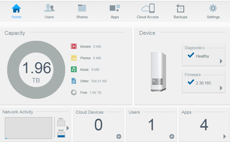

After booting up with Ubuntu Desktop and copy and paste the commands, My cloud is back up but with the original issue.
I am not able to see any shares on the network, I can see the shares from the dashboard.
I have added a new share and cannot see this as well. I have set Public share in the on and off position and have the same results.
Added a new user and password no change.
This unit is for backup for my existing my cloud and will only be used internally.
If I turn on the DLNA media server, this will show on the network. I have updated the firmware to the latest.
What exactly do you mean by ‘cannot see’?
Do you mean that they are not even visible to whatever computer/OS/file manager you are using (what are those, by the way)?
Or do you mean they are visible, but you are denied access?
From the network I cannot see any folders that are shared from My Cloud, default or not. I can see my shared folders from my computer on the network
I have used both Windows 7 and Windows 10 and have the same results.
See images.
