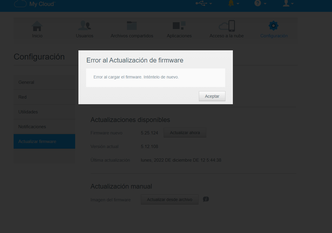

Now it is working fine, but I can see there is now a new firmware available, so I can upgrade from 5.12.108 to 5.25.124. But the upgrade fails.
It completes the download up to 100% but in second step, which is installing, it says immediately “error in downloading” (“error en la descarga” in spannish).

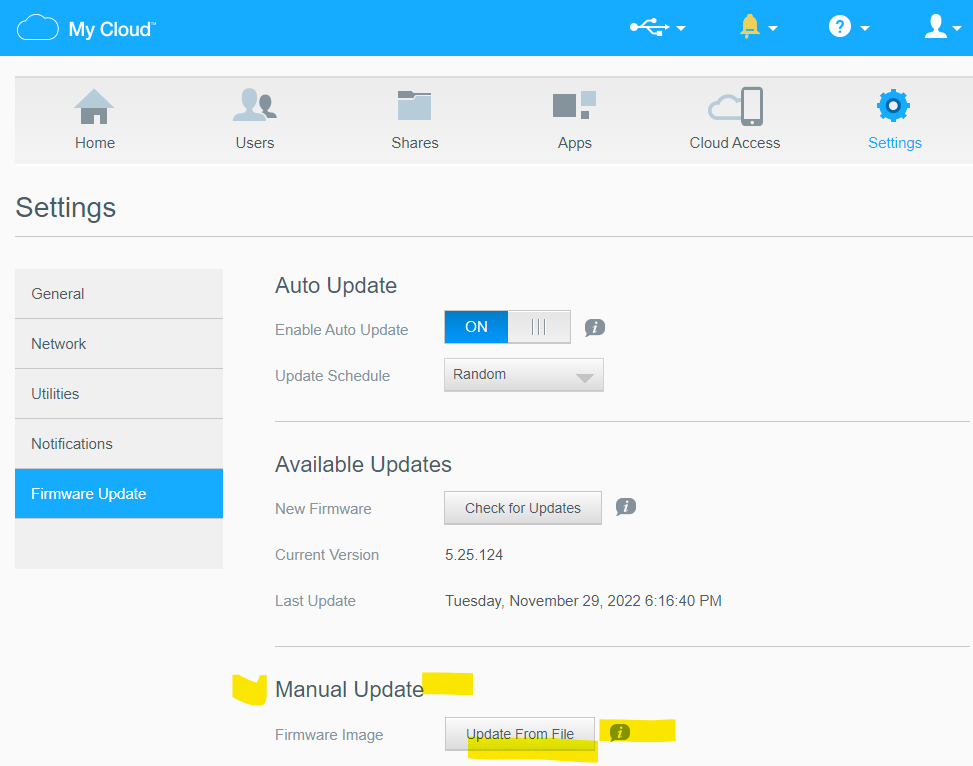

Download the update to your desktop or if you already have it saved somewhere move it to your desktop.
Once it is on your desktop open your dashboard and manually install from there. See example image below. Click on, Update From File and select the file on your desktop.
Example image from my update of firmware.

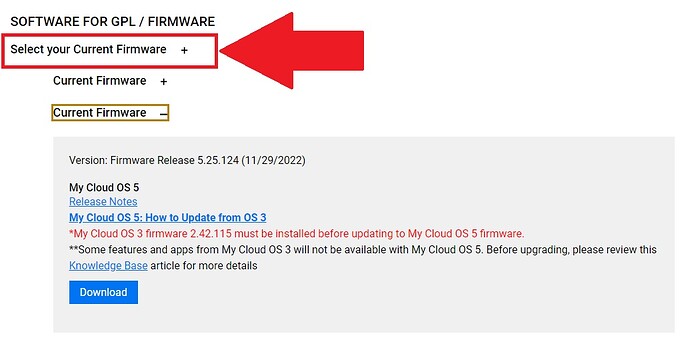

I found finally the place where to download the newest firmware from:
I downloaded first the file named “WDMyCloud_5.25.124_prod.bin”
BUT … still some error as shown in attached snapshot.

Yes, I saw your correction. I think I am downloading the correct file (WDMyCloud_5.25.124_prod.bin), but still same error, either manually with this file, either automatically

As explained in reply to cat0w, I think that now I am downloading the correct file (WDMyCloud_5.25.124_prod.bin) from the correct place, but still I have the same error, so it doesn’t work either automatically , either manually. I will try to join WD 's support.

What specific My Cloud model do you have? The second generation single bay My Cloud or one of the multi bay models? The firmware for each may be different so one has to download the correct firmware file. You select the option titled: Select your Current Firmware to find your current OS5 firmware version to download. For example if one has a second generation single bay My Cloud model this is the correct (and latest) Firmware Release 5.25.124 (11/29/2022):
https://downloads.wdc.com/nas/WDMyCloud_5.25.124_prod.bin (approx 166MB in size)
