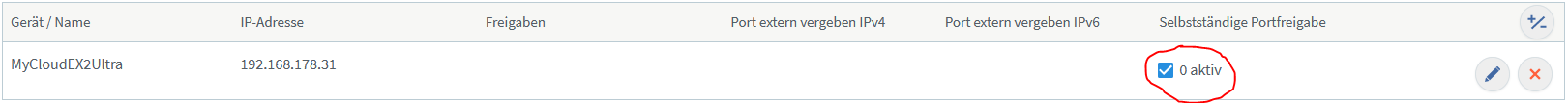

Hello, I also use a fritzbox 7490 and can`t also establish a port fowarding connection. The ports are opened via upnp for ftp, http and https in the router (21, 20 443 and 80), but there is still the relay connection type.
Using https for the login leads to the http connection, do I have to import the NAS certificate to the browser (it is marked as “not valid” when trying to use the https way. The Dns resolving is o.k.
With kind regards

The screenshot isn’t from the mobile app. It is from my desktop browser.
I accessed my “My Cloud EX2 Ultra” with the desktop browser and the connection type is relay which I don’t understand because with OS 3 it was a direct connection.
UPNP is enabled in my router and with OS 3 the necessary ports were opened but with OS 5 it no longer works.
The ports are not opened in the router although upnp is activated.
@Holger81: the screenshot from your device is from the Web dashboard. The web dashboard does not use a “relay connection”. It talks directly to the NAS on the local network. when you enter http://IP address or http://devicename, the browser is redirected https:://device-local-numbers.remotewd.com
