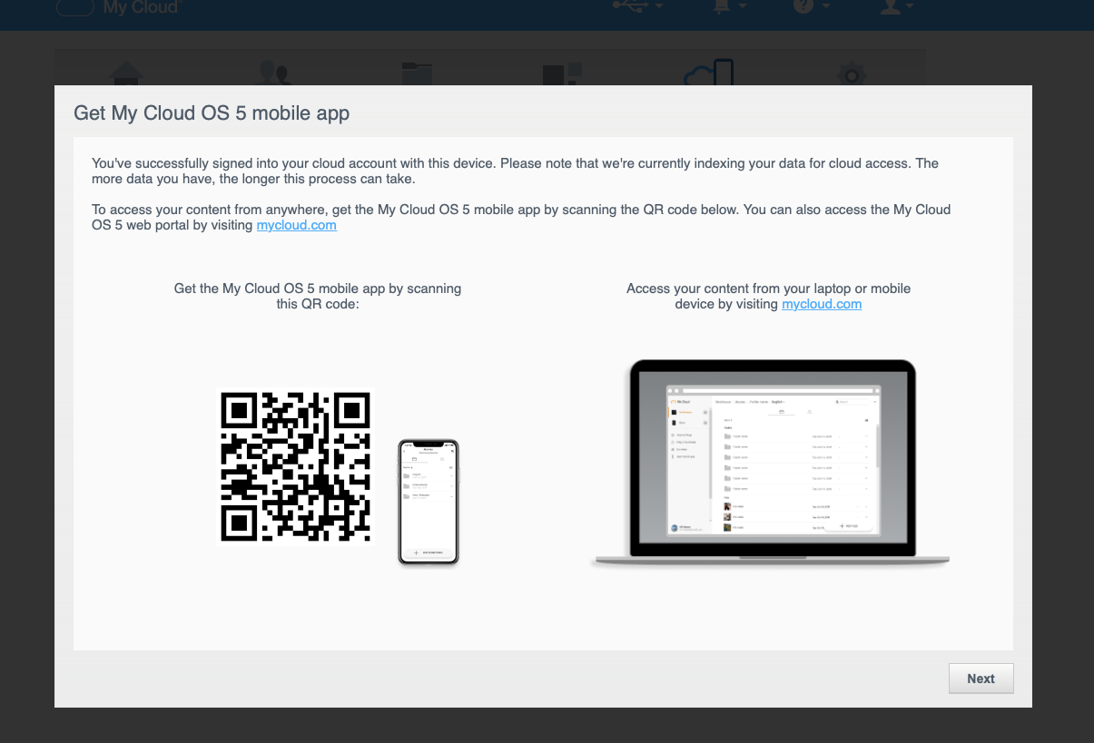

It worked!!! :star_struck::star_struck::star_struck:
Not sure because I used strong password or because I’d set-up the port forwarding. But finally it worked. Thank you so much :sob:
