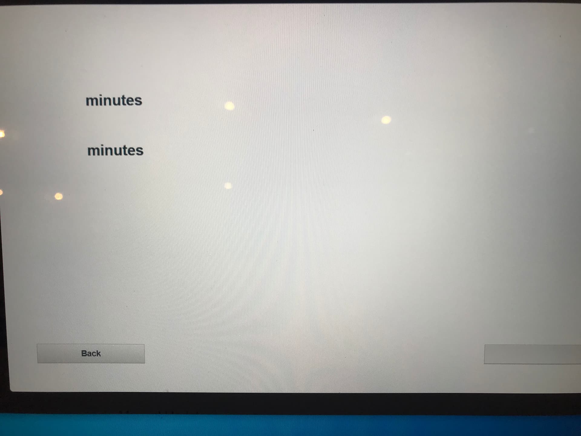

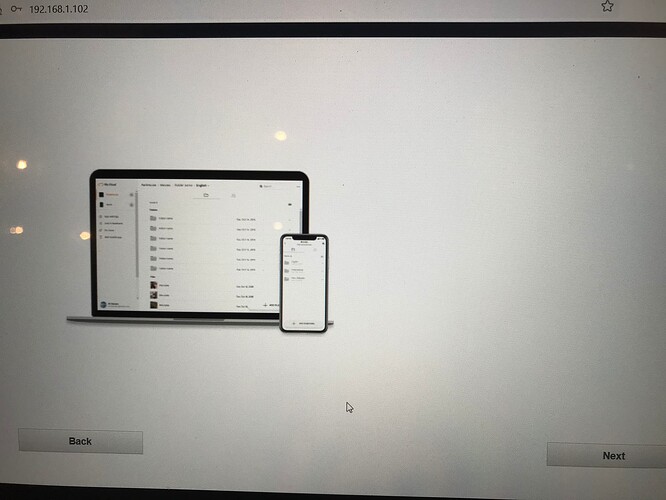

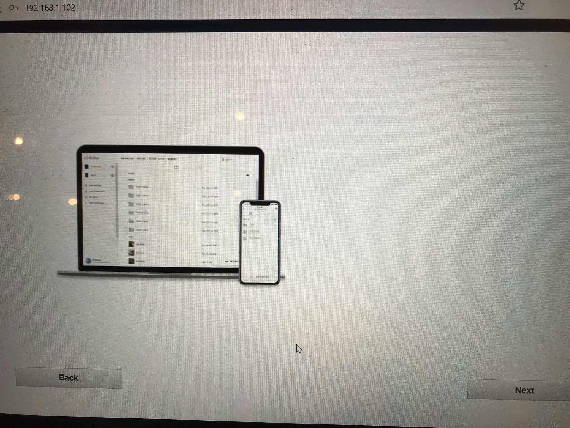

Trying to update my My Cloud 3TB box (-10 ver) to OS 5 from 3 (v2.41.121) within the admin desk top. The relevant windows open but are missing most content, all I get are the back and continue buttons and some graphics . I can tell where I am in the sequence by looking on the support pages that show what the page is supposed to look like when fully loaded.
The question is do I risk clicking what would be the continue button to start the v5 firmware update, if it actually works, or will I be starting a flawed process that will leave me unable to use OS 3 or 5?
Edited to add I have tried this using 3 different browsers, all the same result.

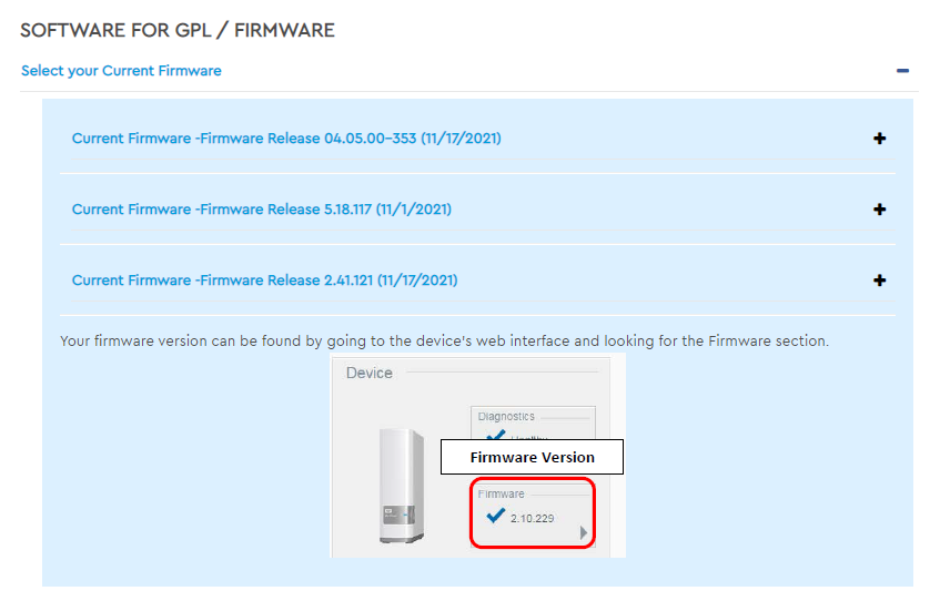

What are the steps you are taking to download and install OS5?
Software and Firmware Downloads | WD Support (wdc.com)

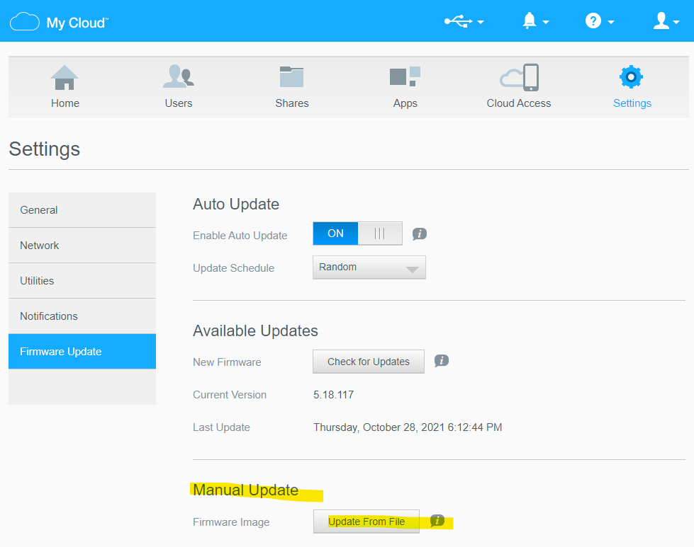

My steps are.
  1. Download the update or OS5 (firmware) to my desktop.
  2. Open the Dashboard and select to do a manual install selecting the file I downloaded to my desktop. The update should take place without any problems.
The following WD Knowledge Base Article may (or may not) be relevant to your specific issue when attempting to upgrade from OS3 to OS5.
My Cloud OS 5: Update Screens Blank and Missing Text
Or manually update the firmware.
My Cloud OS 5: How to Manually Update From My Cloud OS 3
My Cloud OS 5: How to Update Manually From My Cloud OS 3 Without Internet Connection

I shall attempt to manual update from a downloaded firmware file as suggested previously by @cat0w. Thanks
Yes, this is what I did. Ignore the WD automated update. Just get the firmware file from their website and then go into the dashboard settings and update from your PC.
