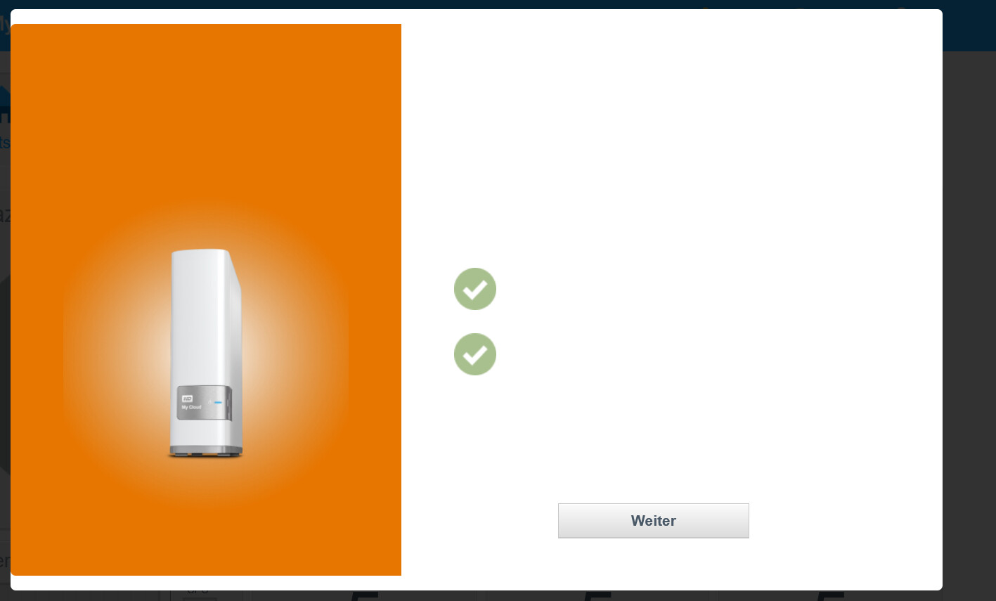

What IS that?
Can anyone explain what this is supposed to be?
Probably the notice for the OS5 firmware update for your second gen single bay My Cloud if your My Cloud is running the OS3 v2.x firmware.

Mhm, thank you Bennor.
This is really dodgy strategy. They want to ask me to install the next OS generation, but forget to display the text. I guess they forgot the localization/translation. What a shame for a world-wide operating company like WD. Anyway, I understand this is not the right place to criticise them. I will see if I can place a support request.
Two comments: They messed up their text resources of the previous OS, so how can I be sure they worked well with their new OS. And second, the above linked page clearly states: There is no way back.
Search both this OS3 subforum and the OS3 forum link above for discussions on the OS5 firmware. Folks are having some issues with it.
Despite WD’s claim that one cannot roll back to the OS3 firmware, there are a number of other discussions both in this subforum and several of the OS5 subforums of people rolling back to OS3 from OS5. The process does require some work and it’s a simple process. At the very least, with a single bay My Cloud unit, one could follow one of the various unbrick methods discussed in this subforum to put the OS3 firmware back on the single bay My Cloud.

@Semilynx We’re unable to preproduce this blank text issue with My Cloud OS 5 update user flow.
Do you have add, popup blockers or anything installed?
Any browser addons?
What browser are you using?
Do you experience the same issue with different browsers?
Are you connected via VPN or is the computer and My Cloud on the same LAN?
The text are local to the device and not fetching anything out on the web.

My primary browser is Firefox 87.0 (64-Bit), uBlock origin installed but deactivated for http : //192 . 168 . 2 . 2/ (which is a static IP), other addons: Brief, Open selected links. I use a restrictive cookie setting.
Other browsers: the very same phenomenon with Chrome 89.0.4389.114, no addons, all cookies allowed, Opera 75.0.3969.93, Edge 89.0.774.63 (64-Bit), even with IE …: orange cloud icon, no text.
Windows version is Windows 10 Home 64-Bit, 20H2, 19042.870

I would like to upgrade now. Still the issue is the same. All I see are windows without text, only buttons to click on. HOW can I judge what I am doing when there is no description that I could read? Could anyone PLEASE offer help?
No matter which browser, no AddOns, no VPN. I am connected via WLAN and no, I am not able to connect via LAN cable because I am physically handicapped. Maybe the text resources are local to the device but it still seems to me that simply the German translation is missing. Can I switch to English language resources?
Found it, switched to English, no difference: empty window!
See the following WD Knowledge Base Article.
My Cloud OS 5: Update Screens Blank and Missing Text
https://support-en.wd.com/app/answers/detail/a_id/31083
Bennor, you are my today’s hero! Finally, the text is visible.
Thank you very much for your support.
Successfully finished the upgrade to 5.17.107. Indexing in progress. Access via Windows explorer works properly. Next step will be the upgrades of the os3 mobile app … but that’s another task for another day.
