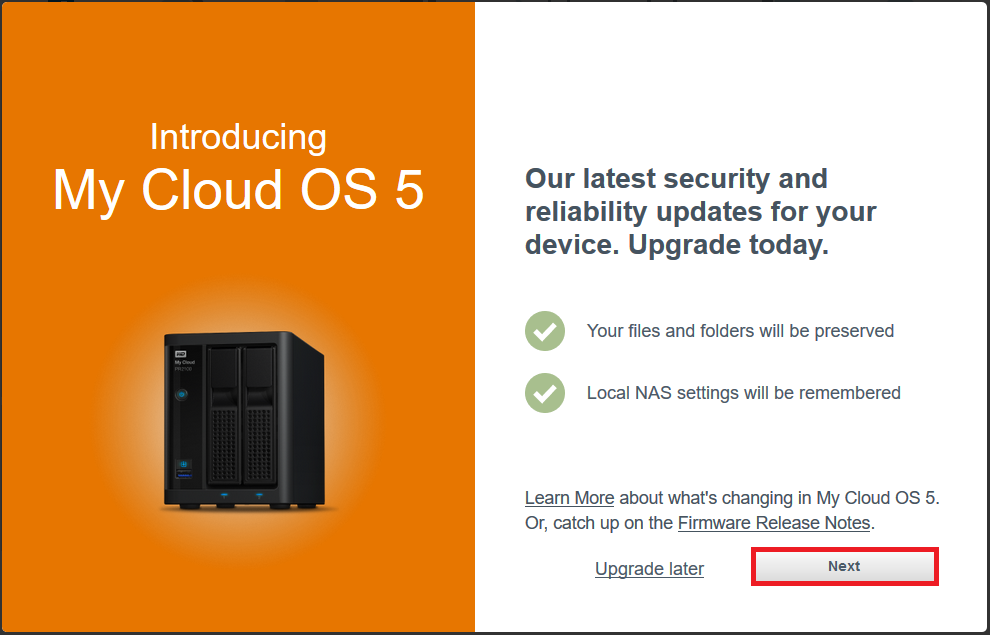

As a troubleshooting step. Try accessing the My Cloud Dashboard from a computer rather than a mobile device and initiate the OS5 update.
I accest the Dashboard from my computer but I can not find the place to initiate the OS5 update.
One of the boxes outlined in red says “Next”. Did you click on that?
If it doesn’t work on your desktop, do a 40 second reset and try again.
My Cloud OS 5: How to Update Automatic and Manual from My Cloud OS 3
https://support-en.wd.com/app/answers/detail/a_id/29383
In the My Cloud Dashboard:
My Cloud OS 5 Dashboard Update
  1. Click the Box NEW OS 5 AVAILABLE
  1. Introducing My Cloud OS 5 click Next
Or manually update:
My Cloud OS 5: How to Manually Update From My Cloud OS 3
https://support-en.wd.com/app/answers/detail/a_id/30092

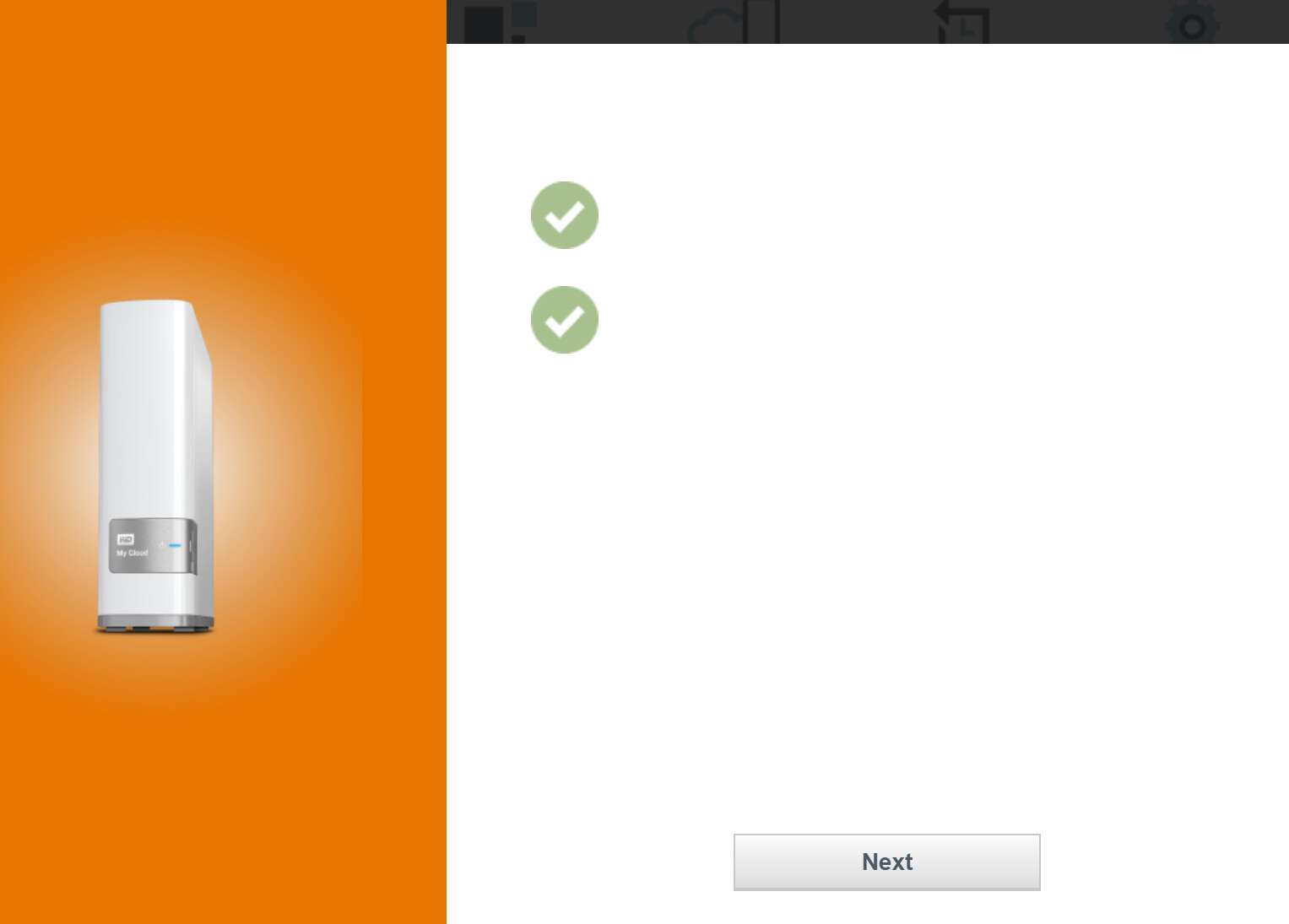

Is anyone successful updating to OS5? I see below issue on my device:
On selecting the icon, i get next as:
Any suggestion please?
Search this forum. There is an “official” way to fix this (a bit long winded) or you can do a 40 second reset and/or a manual install.
See this WD Knowledge Base Article on how to fix that issue and update to OS5.
My Cloud OS 5: Update Screens Blank and Missing Text
https://support-en.wd.com/app/answers/detail/a_id/31083
