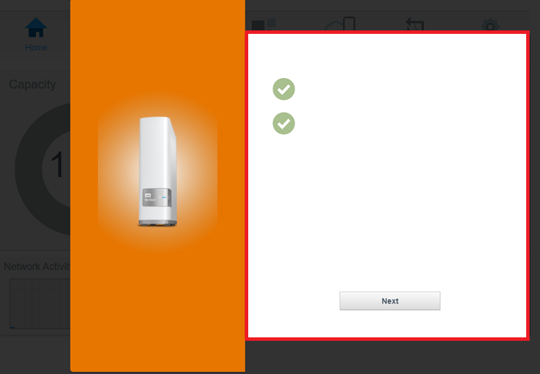

If you see Dashboard screens like those below, then see the following WD knowledgebase article:
My Cloud OS 5: Update Screens Blank and Missing Text
https://support-en.wd.com/app/answers/detail/a_id/31083
Example Dashboard screens:
