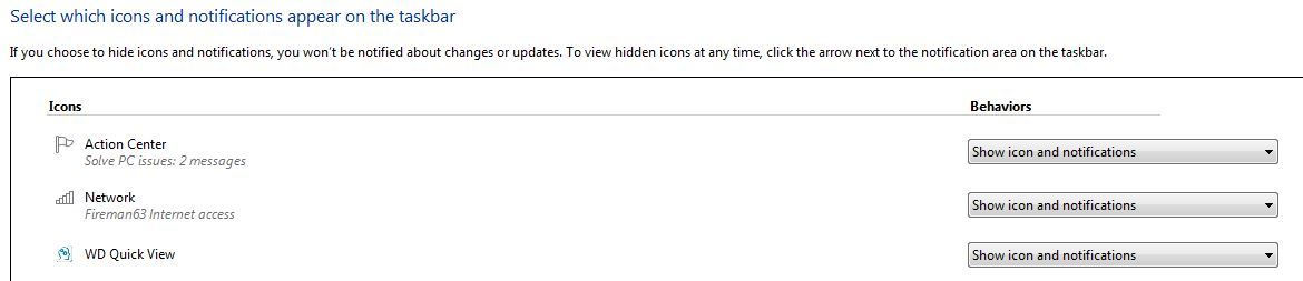

If you are running Windows I am talking about the bottom right of the window. Click on the Show hidden icons button and then Customize as shown in image below.
Choose the following, Show icon and notifications, for WD Quick View as shown in image below.

THANK YOU!!! IT WAS THERE…don’t I feel stupid…I looked everywhere – else.
