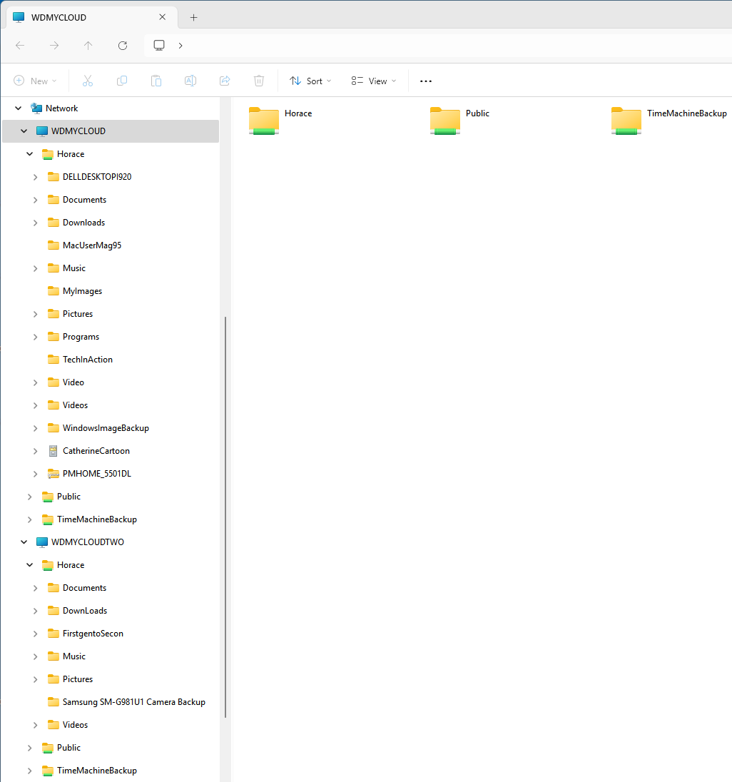

For my two WDMYCLOUDS I was able to get to my Horace share folders by using the UN and Password that I used to set my devices up.
For my first generation OS3 I used Username and no Password.
For my second generation OS5 I had to use Username and Password.
This image shows my Horace share for both devices and all the folders under it. Click on, tap, or activate image to enlarge it.
