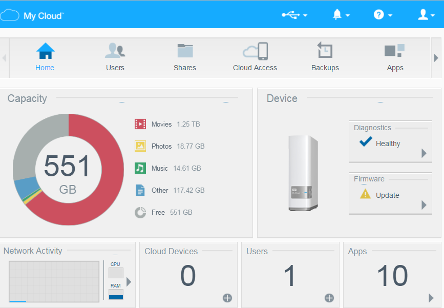

Dear @Bennor and WD Community,
Now MyCloud stay at 2.10.310 and work again.
I start run Full Test for him, just started at 20:10pm (GMT+7).
I stop run these apps: WDSleepFix, WDCrack, UtilsUpdate, UtilsUpdate-extras, Transmission.
WDSleepFix is last app that i stop, just stop at moment. When stop WDSleepFix, all kind of my capacity have… online (before that, it’s just… blue color for all of my capacity).
DLNA Media Server can not show kind of Media on MyCloud (i did Rescan and Rebuild already).
I scared that: if i reboot / update / system only restore for MyCloud, maybe it’ll come back Blue LED blinking.
Now what can i do next, can you give me some advice?
