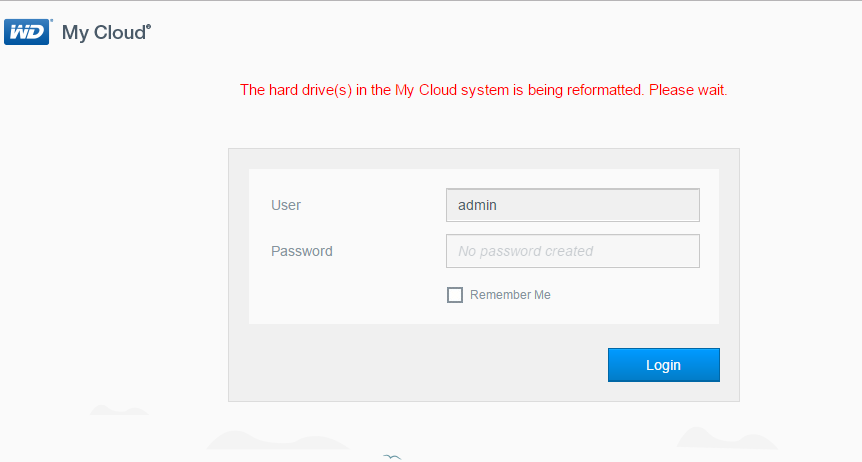

Dear WD Community,
Now, i’m doing Quick Factory Restore in FW 2.10.310 by Google Chrome.
It’s loop:
  • It’s been 100% processing and then Rebooting (again and again).
  • Check by ping: MyCloud is not reboot, it’s always reply to my PC.
Is it process for Quick Factory Restore?
Philip.
:confounded: :imp:
I’m … unplug power core. Now MyCloud is: …
I think this step must be waited. Let’s Wait and See… !
Philip.

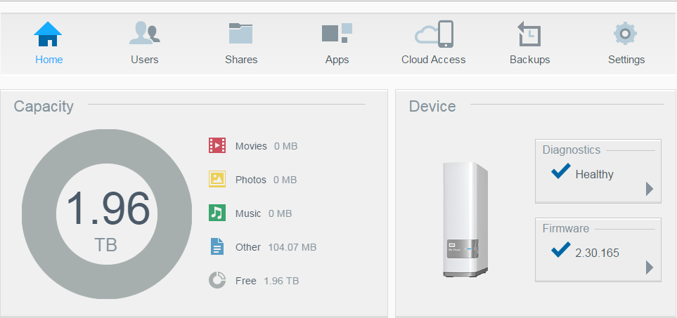

Dear All,
After re-format hard drive, update FW.
=> MyCloud working again! :innocent:
I have a best experience with MyCloud.
Case close.
Thanks for WD Comminty, @Bennor, @cpt_paranoia, @cat0w, @Fox_exe.
Philip.
