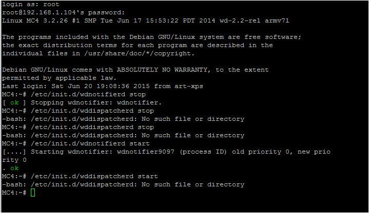

Done. After the first four commands and insertion of USB external (WD Passport) drive cable the disk was not recognized.
I pushed it by inserting the second series of commands (stop-start) restarting services and. the USB drive has been found (Web UI).
Then after a short time the connection was lost. Neither Web UI (Dashboard) access, nor local web. Same as before.
Attached USB My Passport contains about 1 TB of data.
Here are two images of puTTY command window:
Is the problem located (as usual) between my chair and a screen, or elswere?
Things bizarre happen.
Trying update firware from a file I have got the following message. The disk has at least 3TB of free space.

and the other problem is that you are on a different firmware then myself so I have no idea if that firmware works with your USB drive but we can try…
so let me say this again
DO NOT UPDATE FIRMWARE while we are trying to fix your USB access.
Also I cannot see your photos until WD approves them which I think is next year… that is to protect us users from posting up **bleep**.
So whatever you have posted up, I cannot see.
and btw don’t keep issuing commands over and over…
you do this once!!
/etc/init.d/wdnotifierd stop
/etc/init.d/wddispatcherd stop
/etc/init.d/wdnotifierd start
/etc/init.d/wddispatcherd start
you need these programs to mount your USB drive… so only once… and leave it on… I repeat don’t start stop start stop start stop.
You should see your USB drive mounted in the UI and make sure you TURN OFF SLEEP… (I don’t think sleep will have an issue here but turn it off anyways).
If you lose your USB drive after “WAITING” and accessing it ok… then there is another problem…
Tech support is signing off and heading for the gym… I’ll check into this later on tonight… but good luck. Go and read all my other posts to see if they help. Your firmware version may have a USB bug that cannot be fixed and this is a WD problem which also cannot be fixed by exchanging for another Cloud. If you can, get your refund if that is your situation.
