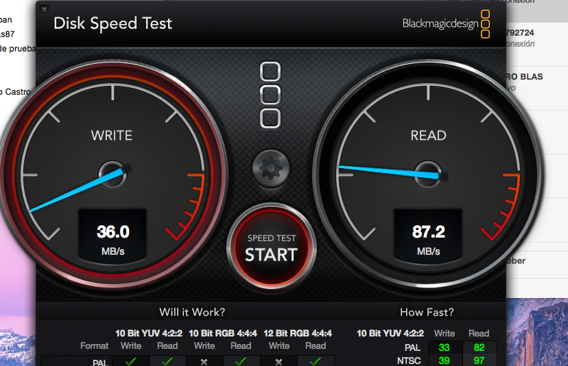

Hi.
I have WDMyCloud 4Tb with FW →   WDMyCloud v04.01.02-417 : Core F/W
I haven´t this problem, use Cat6 cable in WD an Firewall conection…
Good speed in test and real live
Ten minute ago, 30Gb in 1080p videos late 10min aprox…
