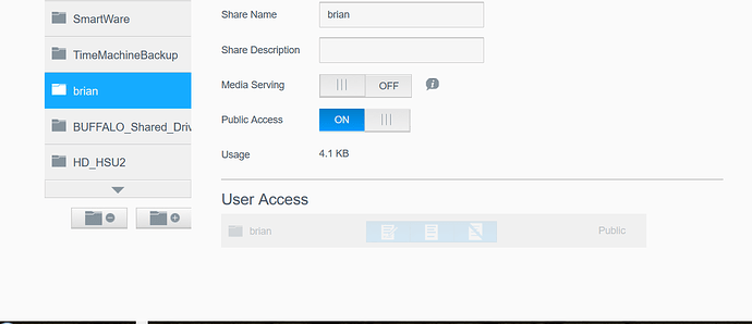

Second, can you post a screen capture of your My Cloud Dashboard Share page so others can see what you see. That way others reading this thread can see exactly what you see.

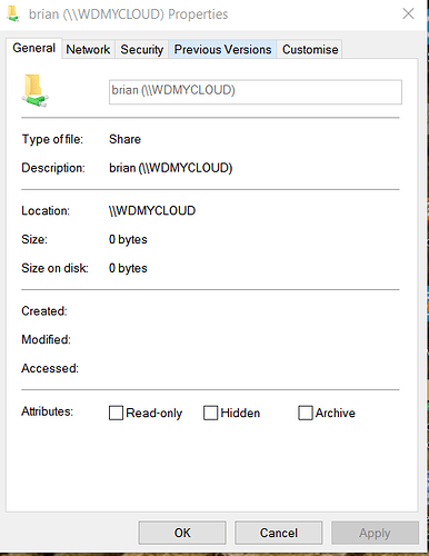

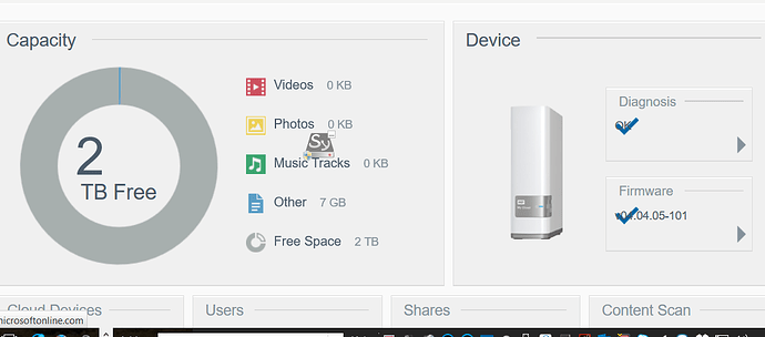

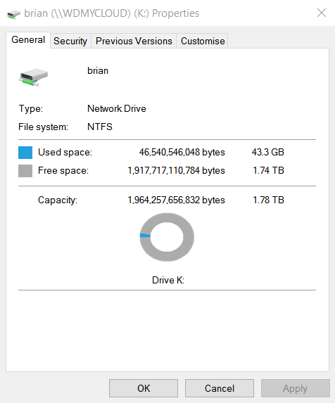

I have a few screen shots. When i unplug external drives the capacity showing is 2tb. But properties show space used.
This image is normal for Windows when selecting a Share through Windows File Explorer, you would need to view the contents of the Share and then select all the contents then select Properties to see the space used by that Share.
When the USB drives are attached, if the Dashboard Home page is including the free space of those drives in the total Free Space calculation you can stop the My Cloud from including the USB hard drive free space in that total by disabling USB Content Availability in the Dashboard Settings.
Can you post a screen shot of the Dashboard Home page with the USB drives removed? What does capacity section indicate with the USB drives removed?

Turned Usb connections off. I have been using WdSync as well. If This is correct its probably safe to say I have lost everything ? The screenshot earlier of properties showing 48% used is then incorrect.
