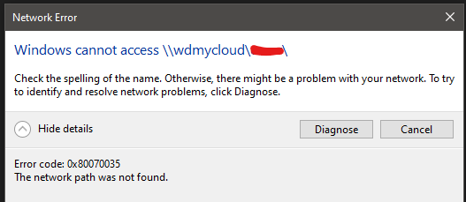

Hi Bennor, it’s me again.
I can ping mycloud. My router is giving a fixed IP address to the MAC of the device.
I can enter dashboard OS3 using different web browsers, but it’s not stable, seems like it hangs. But led still “blue” (actually i changed to green as the blue was burnt).
I was able to enter twonky, but not anymore as I yesterday disabled Media Streaming, iTunes Server
I was able to enter remotely using mycloud on web or mobile app, but it was very unstable, so I disabled it yesterday
I was able to access my mapped drive, but not since last month
Mine is a MyCloud 4 TB Firmware v04.05.00-342 : Core F/W model WDBCTL004HWT-00 1st gen.
I was reading the forum and saw a way to access my shares using something called WinSCP
So i guess I can extract the data without much effort, however I would like to transfer it to my OneDrive cloud, but I don’t have the full space available on my computer hard drives to make the full transfer at once.
How can I remap mycloud as network drive again to my Windows PC?
Try mapping the My Cloud using it’s IP address and see if that works.
Try using different network cables to connect the My Cloud to the router. Try a different router port if one is available.+
Because you have a first gen single bay My Cloud, make sure SMB1.0/CIFS is enabled in Windows. Microsoft tends to disable that setting through patch updates.
How to Enable SMB 1.0/CIFS File Sharing Support on Windows 10
https://support-en.wd.com/app/answers/detail/a_id/4155
As a last resort one can extract the My Cloud hard drive from it’s enclosure and connect it to their computer using a USB to SATA adapter (or docking station) or using a spare SATA port on their computer. Then using a Linux driver for Windows ( Ext2Fsd, Linux Reader, Ext2explore, Linux File Systems for Windows) or using Windows 10 WSL 2 (mount EXT4 in Windows 10) one can mount the My Cloud drive and copy the user data from the EXT4 data partition off the drive to another location.
