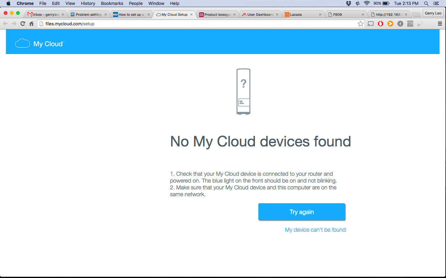

Hi @mike27oct, thanks for getting back to me on this. So on to my progress :slight_smile:
  • Reset the device.
  • Wait until 3 minutes to get the blue LED light, steady.
  • Go to the MyCloud.com/Setup
And got the following;
Screen capture #1
Screen capture #2
Screen capture #3
Screen Capture #4
And the process kept repeating again, where basically, the device is not getting recognized by my local network. Any ideas how solve the situation? The other thing is, I just realized that it’s totally different method from the one on the instruction manual told me to do? Any ideas why?
