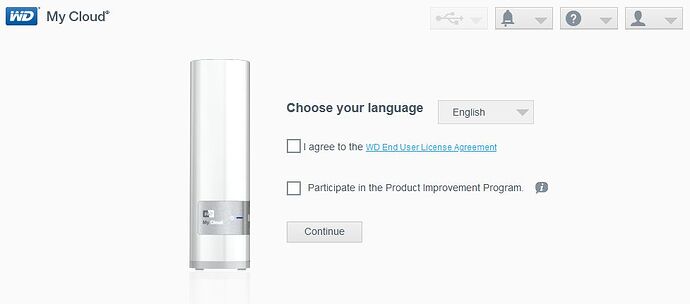

Edit to add: Did a quick test on my first gen single bay My Cloud. Did a 40 second reset as the WD directions posted above indicate.
After waiting for the boot up to complete after the 40 second reset this is the screen that got displayed:
After I checked the “I agree” check box (I left the Participate check box unchecked) and then clicked the Continue button I get the following screen.
Clicking the Cancel button brings up this screen.
Clicking on the OK button brings me to the Home tab screen of the first gen v4.x single bay My Cloud. When I click on the User tab the following screen is displayed.
All previous user accounts other than Admin are gone (per the 40 second reset). However any prior account Shares are still present. The administrator password option is set to off. Which means one should not be presented with a login screen when attempting to access the My Cloud Dashboard when they attempt to access it again (after closing the browser). Once the password option is enabled (and one enters a password) for the admin User then one will be required to log into the My Cloud Dashboard with the admin user name and it’s password.
