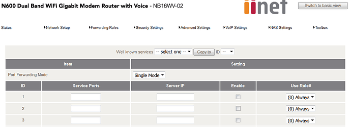

Is there a need to set port forwarding inside the router as well? The following is an image from the router set up but I don’t know what to do with it:
TIA … Greg
Generally when the My Cloud Dashboard indicates a connection is established under Remote Access one typically does not need to configure their router for port forwarding. However, sometimes its best to set port forwarding within the router just in case. Generally its best to refer to the router’s user manual for the directions on how to port forward. If one does an internet search for Netgear N600 port forward they’ll find several guides on how to configure port forwarding within the Netgear N600. Here is one such general guide: http://www.ports3658.com/2012/05/netgear-n600-port-forwarding.html

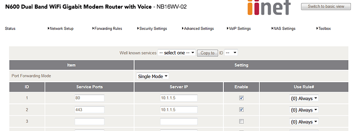

OK, I’ve used the router manual and had a go, set it like this …
but when I try accessing MyCloud from the WAN I get the message that the drive is offline. Seems there is a variety of things not set right … Greg

In rare instances one’s broadband provider may block port 80 (and other ports), in which case you may have to configure the Remote Access for Manual and use alternate ports. For example 9080 and 9443
