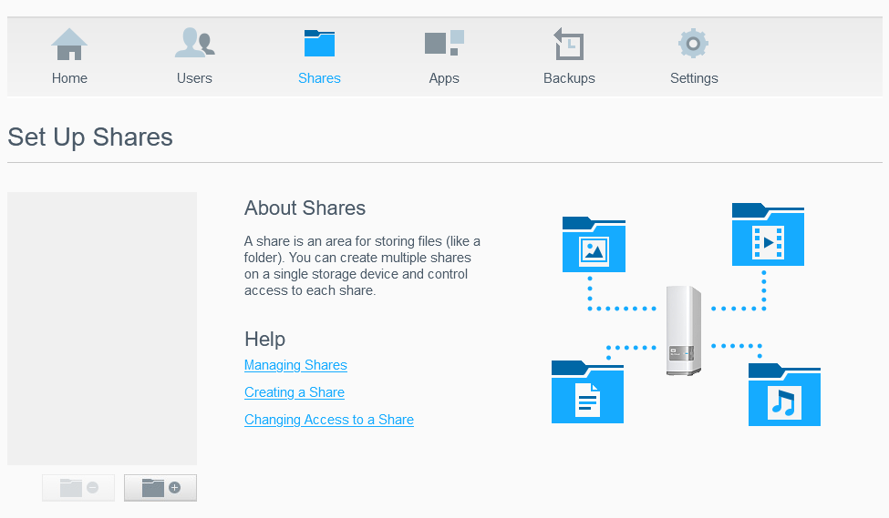

Post a screenshot of the My Cloud Dashboard not indicating or showing the drive so others can see what you see.

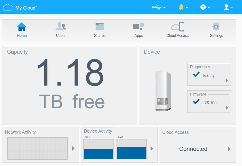

Do you own OS 3 or OS5 device? See images below.
OS3 Dashboard 1st Generation WDMYCLOUD
OS5 Dashboard 2nd Generation WDMYCLOUD

As requested here is a screenshot of my dashboard.
Your dashboard show that you are on a gen2 my cloud. firmware version 2.42.115. OS5 does not work on a gen2 My Cloud.
Note the first screen shot. Click on the Diagnostics section that says Caution and see what it indicates. It may provide further information on the specific issue.

As you would expect the Drive Status has a fault, I would image it’s due to not being able to see the drive.
For example if you try to create a share it will outright tell you that no volume can be found.
