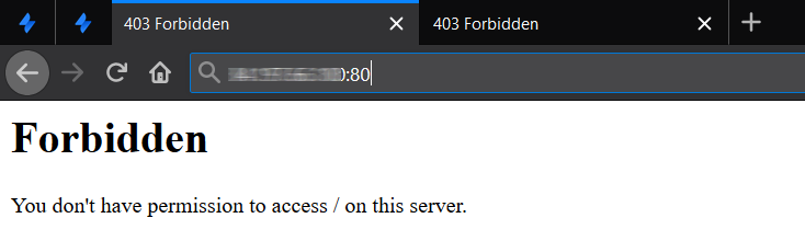

I cannot access the dashboard outside my home network. Inside my home network accessing the dashboard is no problem. I would really appreciate it if someone can give me a clear answer what the problem is.
I would also like to know if there are people who are able to access their dashboard outside their home network.
My Cloud is directly connected with an ethernet cable to my modem router. No access points or switches between them.
I followed every single step from this page:
Error
  • Access My Cloud Remotely: PROBLEM
    Both HTTP and HTTPS (80 and 443) don’t allow access to the dashboard
    403 Forbidden - You don’t have permission to access / on this server.

Hi, yes I know how it works, I use:
http://mypublicip:80/
https://mypublicip:443/
Everything is correct in my router. Router firewall is off. Also everything in MC is correct.
Did you even read my post and toke a look at the screenshots? :face_with_raised_eyebrow:
Also the Port Forwarding Tool can access the ports meaning they are open.

Not being able to access the My Cloud Dashboard from a remote location is a known issue discussed in the past. The problem is the My Cloud Dashboard typically rejects connections from computers/devices that are outside of the IP address range of the My Cloud.
Use the forum search feature, magnifying glass icon upper right. to see the past discussions on this. Some have apparently hacked/modified the firmware using SSH to allow for remote access from non My Cloud IP subnet ranges.

Why does WD need to change the page? As indicated at the bottom of the page under Applied Products the single bay My cloud IS NOT supported when it comes to remote access of the Dashboard following the directions of that Support article. The single bay My Cloud Dashboard (at least the first gen v4.x firmware version) does not have the Dashboard Cloud Access option on the Dashboard > Settings > General tab.

No one seems to be “offended” rather just pointing out that the single bay My Cloud cannot do (and why) what the OP’s WD Support support link for other My Cloud models indicated. The single bay My Cloud doesn’t have the option in the Dashboard > Settings that the multi bay models have. As previously mentioned there are workarounds; from hacking the firmware (discussed in other threads) to fix the IP address lockout to using VPN to using SSH. For example two past discussions on using SSH to access the My Cloud Dashboard Remotely:
