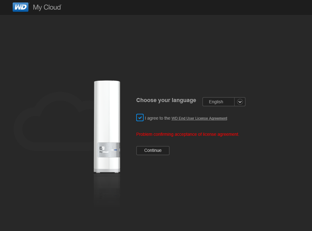

and now to perform the steps as before, is that I have access to the web menu to perform a quick restoration of values and a subsequent firmware update, but as I say there is no way to access the settings even I had the blue light perfectly, to access the home page and try to change the language to Spanish I get this error and no way even putting another language:
And if I try to access the main screen leaving the English language selected to mark the tab of the terms me this out:
And there is no way to enter setup, please have if you can help me solve this, thank you very much hope the answers.

If you haven’t done so already, try performing a 40 second system restore via the restore button on the back of the My Cloud.
http://support.wdc.com/Knowledgebase/answer.aspx?ID=13986
Many if not most unbricking processes recommend performing either a reset or restore after unbricking.
If I already did, but still the same.
This is how this partitioning my Cloud 3 tb.
It is right or see something wrong?
