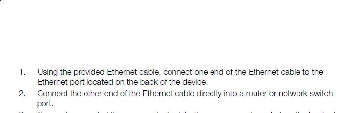

According to the full user manual for this model (which can be downloaded from WD) you have this connected incorrectly.  The computer and EX4100 are not to be directly connected to one another.  They both are to be separately connected to the router directly, or through a network switch.
See image snip from page 10 of manual below.

What you say customer service said is news to me.  Look, ideally, a NAS should be connected to the home network (i.e. router) so ALL your devices, including computers can access the NAS.  When I have commected a fast USB 3.0 drive to my fast PC  and copy a file through my gigabit network to my NAS I have reached speeds over 100+ MB/sec.  The NAS specs say top speed can be 115 MB/sec.
Get the user manual and read it so you know how to use this thing.
