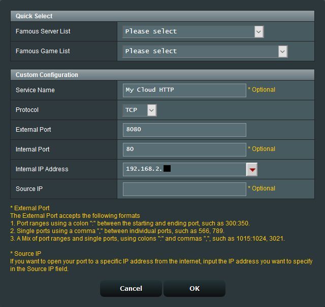

Here is how I have port forwarding setup on a first gen (v4.x) single bay My Cloud and on an Asus RT-AC68U router (when I use the port forwarding option). The My Cloud is connected to the Asus router via Ethernet cable, and the Asus router is connected to the broadband router/modem via Ethernet router. The broadband router/modem is configured (as best as it can be) for bridge mode.
On the Asus router, UPnP is disabled.
On the Asus router on the Virtual Server / Port Forwarding page, Enable Port Forwarding is set to ON.
Next the two port forwarding entries are created and then saved. In the past using the same port number (example: 8080 and 4443) for both the External and Internal ports worked (at least for me). Currently however it doesn’t work, instead I have to use the the port values (example: 8080 and 4443) for the External ports and ports 80 and 443 for the Internal ports. The Internal IP Address is the IP address of the My Cloud.
End result looks like this:
