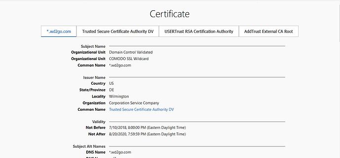

It appears to be a problem with the ssl security certificate used by WD which expired on 8/20/2020. When using MyCloud.com, if one accepts (at least with a web browser on a computer) the expired certificate one can access the My Cloud device after reloading the page (at least I can).
