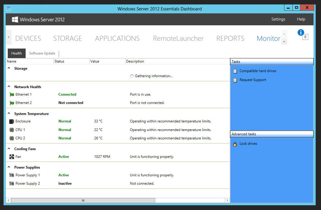

This past weekend I decided to see what it’d take to get Server 2012 running on my sentinel.  As it turned out, it didn’t really take much at all.  I just used the Windows 7 USB download tool to transfer the iso of the Server 2012 essentials dvd to a usb stick.  Plugged the usb stick in the sentinel, remoted into it and ran the setup.exe from the usb.  Stepped through some of the initial setup (going the clean install route) and the server started the install.  In under an hour I looked up the IP address that the sentinel now had, tried going to http://NewSentinelIP/ to continue the setup like you would during a restore, but the website would through an error.  Turns out you have to connect by machine name.  The machine got a new random name that I found through my router setup page, so I connected to that web address http://NewSentinalMachineName/ and I was able to continue the setup process.  After a little while and a bunch of reboots, I was sitting in Server 2012 on my sentinel.  Now of course going to Essentials 2012 brings new issues, like some of the ones mentioned before about the fan and LCD, but I’ll try and figure those out.  And using Essentials 2012 creates a domain and the box wants to use it’s own dns so I’ll have to figure out that as well.  Just want to say though that the drives are all working and kept all the data through the new install!

Got even further!  Most of the WD specific things are working now as you can see.  The big thing was getting the Enclosure Provider service.  Good thing .net Logs errors well, I was able to find out that service needed the new server 2012 sdk dll’s locally.  Still have to figure out the storage info there in the screen shot, but everything else is working now!
I think I know why WD hasn’t said anything yet on server 2012.  It has to do with Intel not having a version of their RST Raid driver that works on Server 2012 yet.  That’s why I think the Storage section in the Dashboard Monitor is unable to get any info on the hard drives.  I’m definitely leery of putting the current driver that is used for the sentinel on in 2012 as I’ve heard some people get blue screens and all when messing with the RST drivers on other machines.
