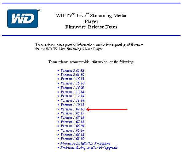

Tony , i think Geoff is running firmware revision 1.09.10 (as per the Subject title) on the WDTV Live Streaming …
Which is a bit old … and may require a “sequential update” ie. update to 1.16.13   first… then update to 2.02.32 ?

Hi Joey,
I’ve grabbed about 4 different firmware versions on your list in the image and was trying 1.15.10 as my step up attempt.
