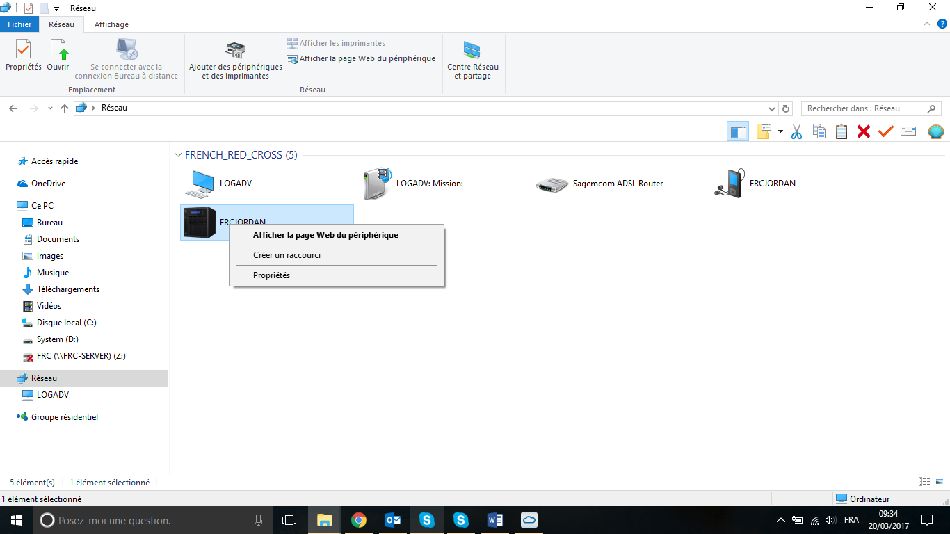

Unfortunatly the icon of WDMyCloud doens’t appear when I click on network. It’s exactly my problem. :frowning:

i already relaunch the My Cloud + the router + laptop. Still not working. This is how it is appearing on my laptop.
On the Icon frcjordan it’s just giving me the possibility to open the website or to connect on the Mycloud as Admin
