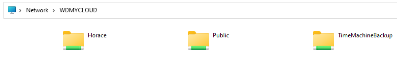

With your WDMYCLOUD connected to your router are you able to check and see what IP address is assigned to it. Using that address you should be able to open the Dashboard.
If you get that to working try \\WDMYCLOUD as the address in File Explorer and you should be able to see your shares. See example image from mine below.
Make sure the My Cloud is directly connected to the router’s networking port using an Ethernet cable. Have the computer connected to that same router, using an Ethernet cable if possible. Avoid using powerline adapters or network extenders when troubleshooting access issues.
First troubleshooting step is to access the network router’s administration page and see if it indicates the My Cloud obtaining an IP address. If so, make note of that IP address and try accessing the My Cloud by it’s IP address with Windows File Explorer address bar (ex: \\192.168.1.100) .
Another troubleshooting step. For OS3 My Cloud devices, if using Windows, one may have to enable Windows File Sharing (and SMB1.0). And set the Windows Network Profile to Private and not Public.

My question is when I try connecting my laptop and MyCloud OS3 to the home ethernet router and then I try to go into MS File Explorer, it can’t seem to detect the MyCloud OS3 NAS.
