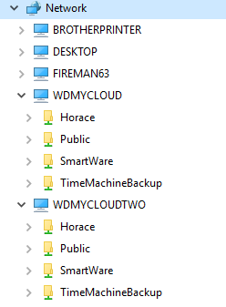

@gjkozy If you have a WD My Cloud WDMyCloudImage you can do this. You should have already created a share using the Dashboard. See more information using the below link and the User Manuals.
You can use File Explorer to do what you want to do. You look at Network>YourMyCloud. Horace is my share where I put only what I want in it.
Thank you, I get a directory listing similar to this, but I cannot move files or folders like I do with my regular storage.
If using Windows File Explorer you may be seeing/accessing the media server of the My Cloud not the file server which will explain why one cannot move files into the Shares on the My Cloud. Also note that you cannot move files/folders to the top level directly of the My Cloud. Instead one has to use the My Cloud Dashboard to create the top level Shares (folders) then copy files into those Shares.
