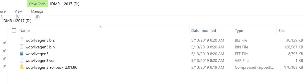

I am getting the same error message and I believe I followed andrey_andrey’s instructions correctly, but I still get the same message on my TV screen
Model of my WD Device:
Content of my 68gb usb drive:
Is there anything else I can try?
you downloaded Gen 3 WDTV Rollback Firmware
your device is a Gen 2 WDTV … so that’s not gonna work
the only firmware available for your device is here: https://support-en.wd.com/app/products/product-detail/p/189#WD_downloads
oddly, they released another version firmware in 2013 (FW 1.06.42_B) … but no download links on the WD Site ? … oh well, should be out there if you google it.
