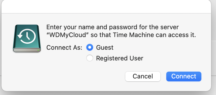

Yes, you can select “guest,” at which point the user and password blocks disappear – but the heading of the pop-up continues to ask for a user and password for the NAS itself – and that has never been required before, nor am I aware of one (there’s one for the administrator – that would not be shared, and each user has one for private shares, but a name and word for the server? Now, I’m stumped. I’ve uploaded a screen shot:
Once you select “Connect” you get this:
At that point you’re dead in the water.
