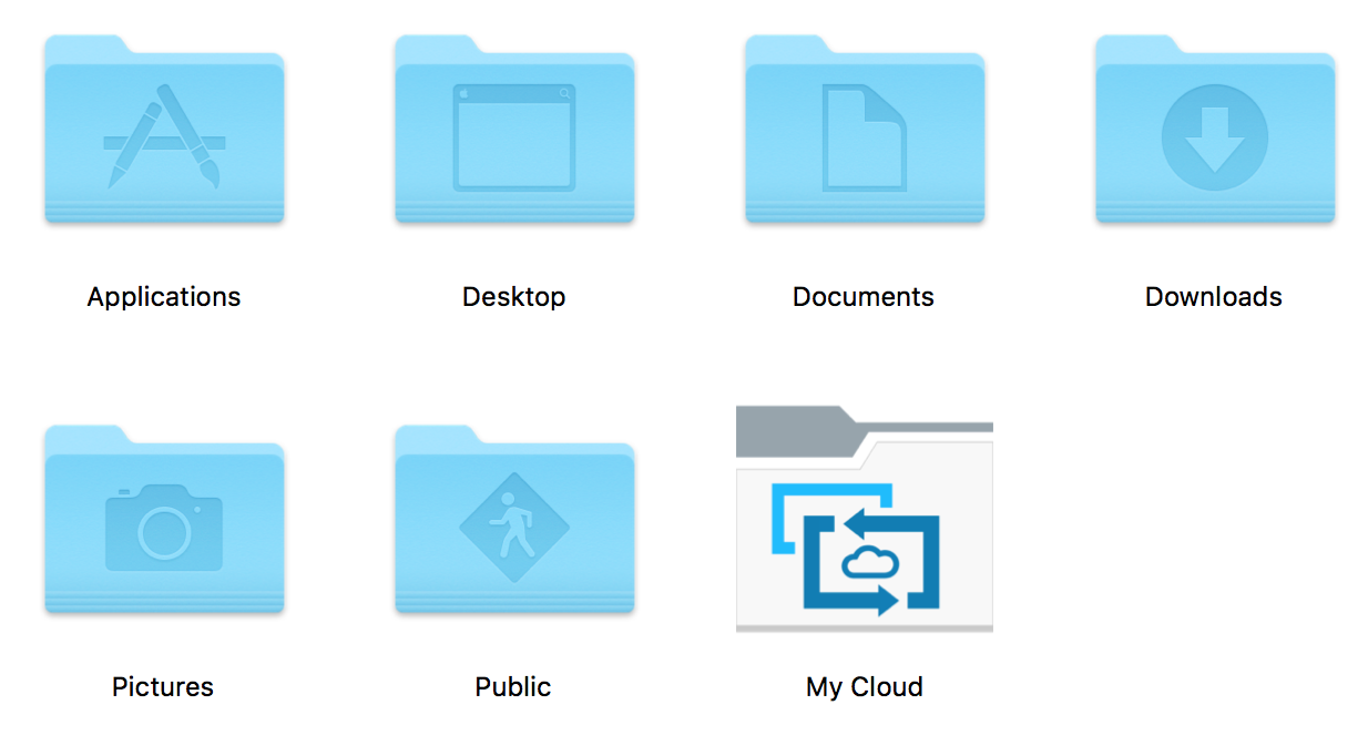

I have installed WD Sync 2.0.0.55 and it installed ok. I selected the usual user folders (documents, pictures, music etc) and it’s “mycloud” folder and it all appears to work ok, with one exception.
