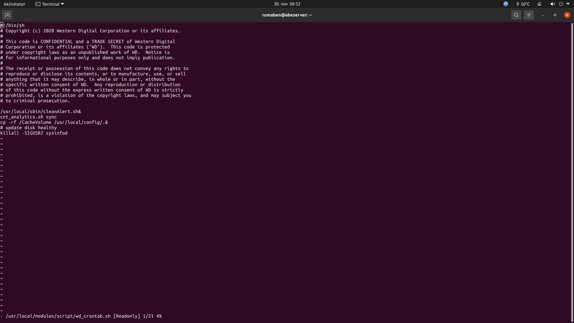

wd_crontab.sh (/usr/local/modules/script/wd_crontab.sh) looks like this:
Edit3: Well i deleted all the sh files mentioned earlier & stopped all i could. Then i #'ed out the two previous crons completely and made them both as locked down as possible with chmod 000. Then we’ll see if they revert. :slight_smile: In the config.xml i just removed ‘pull_wdlog_config’ lines.
I haven’t been able to find & read ‘random_check’ & ‘expire.sh’ yet so i’ll leave those for now. Also no chmod for config.xml because it’s nice being able to configure sometimes inside of the wd html config. :slight_smile:
