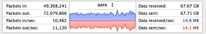

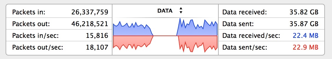

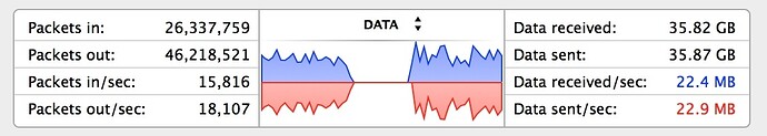

Well, I don’t know exactly what to make of this (again with the caveat that this is all kind of impressionistic, with no real numbers). My CrashPlan backup was writing my iTunes media files from the My Cloud to it’s attached USB 2.0 My Book Studio (previous model) at around 11-12 MB/sec. for most of the morning, with all volumes confirmed (using System Information) as mouted via SMB. Just now, I decided to pause the backup, then unmount and remount the files using AFP, and then resume the backup. Speed jumped up to what looked like an avg. of around 22 MB/sec. (mostly bouncing consistently between 18 and 24). Then I unmounted the volumes and mounted them one more time using SMB. (I always used ⌘-K, rather than clicking on the drives icon under “Shared” in the Finder sidebar.) To my surprise the speeds bumped up a little more, staying mostly in the upper-20s. Here’s a screen shot:
AFP on left, SMB on right. Just eyballing it, to me the average looks about the same. Although the sent speed at the time of the screenshot was 22.9 (using SMB), the numbers were often 25/26 MB/sec, with some peaks over 30. Again, the drives are joined to each other via USB 2.0, and the laptop is hardwired to a gigabit Ethernet router, with Ethernet trumping Wi-Fi in the network service order. The files transferred were similar, with most, if not all of them, being std.-def. .m4v files of similar size (TV shows). And I’m pretty sure that since these formats are already compressed, CrashPlan wasn’t doing any on-the-fly compression/deduplication to this local volume. I’m quite happy with these numbers under these conditions, although I’m curious why it was stuck at 11-12 MB/sec. all morning until I started switching things around. If I had to take a stab at it, I’d say that it depends on the kinds of files that are being written. When transferring the much smaller and more numerous audio tracks, which take up a much bigger portion of my drive, the speeds tend to stay in the low-teens. So maybe songs were mostly getting backed up, and when I decided to do the switcheroo, CrashPlan had decided to do a batch of video files. That’s entirely possible. Here’s another shot from just now, with CrashPlan cranking away on a string of .m4a audio files, with volumes still mounted using SMB:
That’s about as typical as it gets for music tracks.
I dunno. I throw this out for what it’s worth; make of it what you will.
