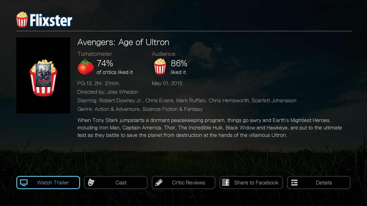

Flixster trailers do work
Tested this on Firmware 1.02.17 … the Old Youtube app no longer works, but Youtube Leanback app does work (term used loosely) … so, i can only assume the “Trailer” feature used the Old Youtube app, and thus is broken. (and looks like it will never be fixed)
So, your only choice is to use “Flixster” on the WDTV … or a XBMC/Kodi device (eg. Raspberry Pi 2) … Youtube trailers work perfectly :smiley:
