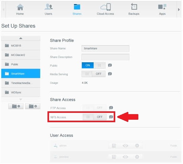

Post edit: Just saw in your first post you are using the v2.x firmware. Apparently the newer generation My Clouds which run v2.x firmware have an option to enable NSF in the Dashboard.
I looked all through the menu system of the dashboard ,but didn’t see that setting though
I don’t have a v2.x version My My Cloud but apparently the NFS option is available in the v2.x firmware as indicated in the following thread post:
http://community.wd.com/t/nfs-access-mycloud-gen-2/159622/10
In that thread I posted some screen captures showing it exists, at least according to the v2.x User Manual.
OK,Thank you
I found it ,but it was already enabled
maybe i will reset the system and reconfigure it
