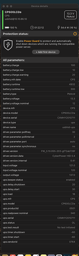

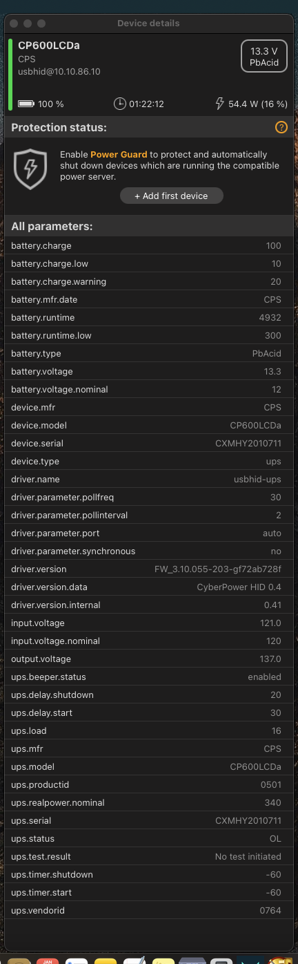

in the meantime, for mac users i found an app in the app store that’s called UPS Power Monitor. it located the UPS connected to my NAS and puts out all the NUT data that the server is reporting, so I see it on my desktop without going ssh or plugging in to the UPS directly. supposedly it has functionality to add a shutdown trigger to whatever networked device i want and i’m trying to get that to work for the NAS itself, so that this tool can monitor the UPS state and shutdown my NAS – basically doing the job that NUT is supposed to be doing, but isn’t for some reason.

here is an example of the app on my mac, what you see here is what is reported by NUT from the NAS:
