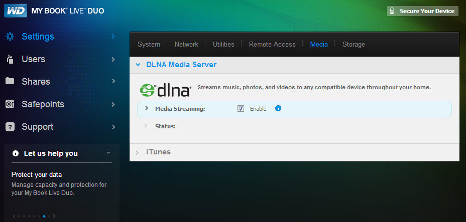

In my My Book Live Duo, I have enabled “Media Streaming”, shouldn’t that could do it?
See the attached image
What happens when you try to access the My Book Duo and what type of media files do you have on it?
Apparently it worked this morning, I can now stream all of my videos on my TV from my My Book Live Duo via my WD TV Play :slight_smile:
I think maybe that the My Book Live Duo should re-index it all before it worked…
Nice, job, looks like you have it all set up for streaming from your NAS
