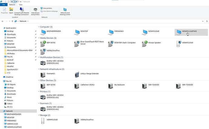

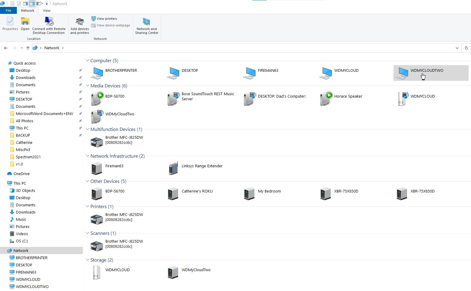

What do you have showing under Network when you open File Explorer?
WDMYCLOUDTWO is my 2nd generation My Cloud on OS5. I’m not having any problems with mine. The IP address on mine is static and does not change.

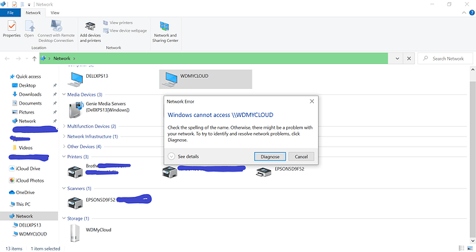

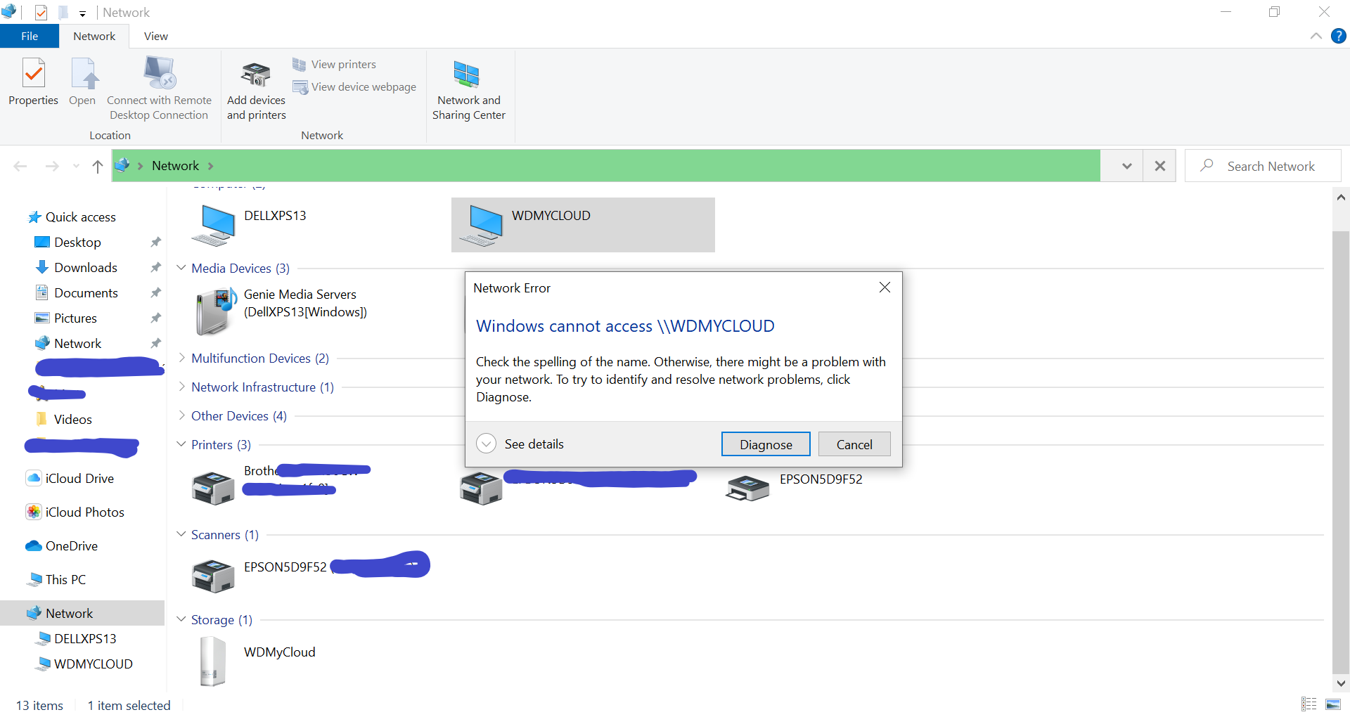

This is what shows in File Explorer, and the message I get when I try to access. Also cannot access the device page by IP address.

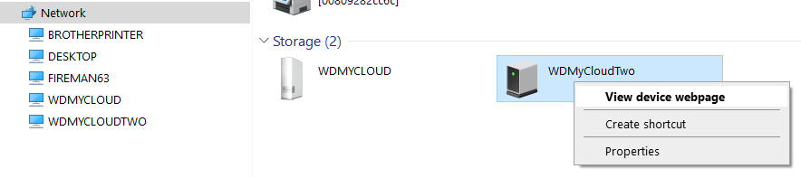

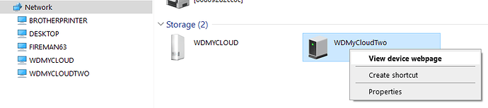

What happens if you right click on it and click on View Device Webpage? Try this on both the WDMYCLOUD under computers except click on Open and the one under Storage click on View Device Webpage.

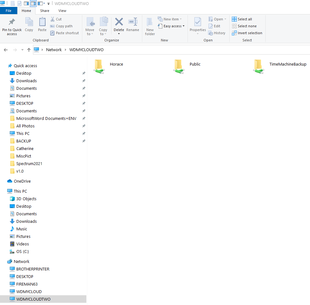

Clicking on WDMYCLOUD under Computers should bring up your Shares. See example images below.
Image One
Image Two
Sometimes right after reconnecting, the shares will show up. After a few minutes, will not connect again.
