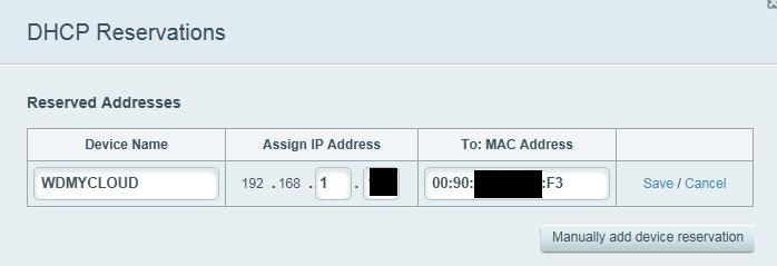

What router do you have? Check to see if you can reserve an IP address for your My Cloud on your router. See example image below.
Posted by,
cat0w (USA)
I have a four year old Apple Time Capsule. The hard disk has gone bad but the router works as usual. I purchased the My Cloud because of the bad disk instead of going with another Time Capsue.
The Time Capsule is plugged into a CenturyLink router connexted to thge internet via DSL
In the Internety section of Airport Utility the iPv4 address is 172.16.0.35
The router address is 172.16.0.1
Airport Utility start screen says this:
LAN IP address: 172.16.0.35
Version 7.6.4
A list of wireless clients all with IP 192.168.0.x
The Mac is connected via ethernet cable to the Time Capsule
In Networkj preferences the IP Address is 192.168.0.5
Router: 192.168.0.1
I do not see anything that sounds like DHCP Reservations in Airport Utility.
Other than that I have no idea what I’m doing or should do to make My Cloud work (assuming it can).
cat, I was able to find DHCP Reservations after all. I set up the Mac Address and My Cloud appears to be working. I appreciate yours and others help.
