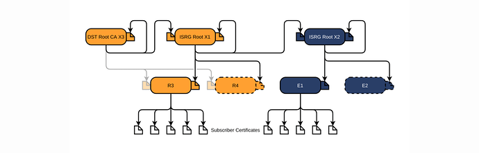

I have the same problem and I already reported that the logs shows certificate issues trying to access to some HTTPS URLs since today afternoon (CET).
Today the “Let’s encrypt” root certificate expired and issues were expected in old devices or devices that didn’t updated the root certificate on their firmware. And trying to access the URLs I saw on the logs their certificate was correct, so everything look like this is the issue.
I cannot confirm 100%, and sorry for pointing to this if I’m wrong, but I’d say this is the problem. A firmware update should be required to resolve it, but if this was not done before the issue, I guess that it will complicate an automatic update, so I’m afraid that if this is the issue, the easiest solution will be a manual update once it’s fixed.
Let’s wait for support to confirm if this is the issue and do not do any hard reset or similar that could affect your data. It seems to be an issue affecting all , or at least, most of the users. DO NOT do anything that could put in risk your data.
