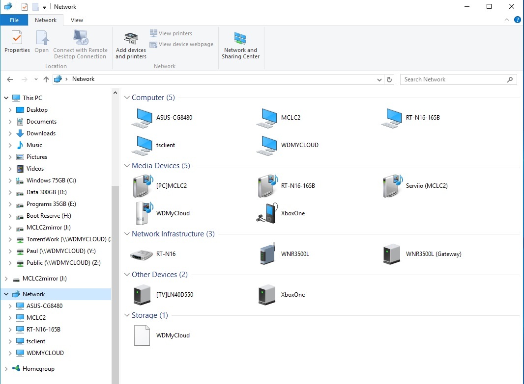

One of my systems (a Windows 10 desktop MCLC2) shows both the WD MyCloud in the Network and shows it under Computers as well!
Not sure why that desktop displays the MyCloud correctly but I’ll check this out further. That desktop is Windows 10 but pre-November update so maybe that is it. It also happens to resides in a different segment of my network (about 1/2 Km away and connected by a wireless 2.4GHz link). The WD MyCloud is not in that segment with MCLC2 but is here in this segment with ASUS-CG8480. Odd.

Confirmed. Windows 10 latest release (.36) is the cause of not showing the NAS devices in Network.
Before and after the November update.

I have Enable NetBios over TCP/IP set ON and I still do not have NAS devices showing. I have always had Enable NetBios over TCP/IP ON. I am waiting for Microsoft to fix this.

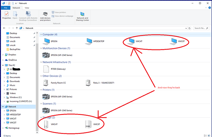

I had the same problems detailed above. But this issue apparently has been resolved by Microsoft. As of today I can finally see Mycloud in file explorer!! Hip Hip Hurray!!
