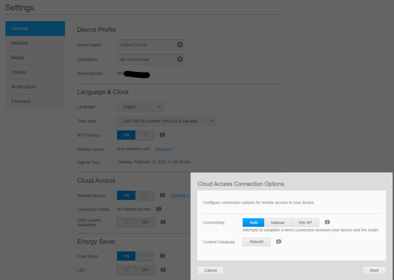

I decided to go ahead and make my My Cloud 1st generation for use on my Network. The first thing I did was in Settings where I changed Network Mode to Static. Images below shows it on my computer now and no Internet Access. Click on, tap, or activate images to enlarge them.
I also pinned it to Quick Access and the Start Menu.
Here is what shows for Cloud Access now on my Dashboard. Click on, tap, or activate image to enlarge it.
