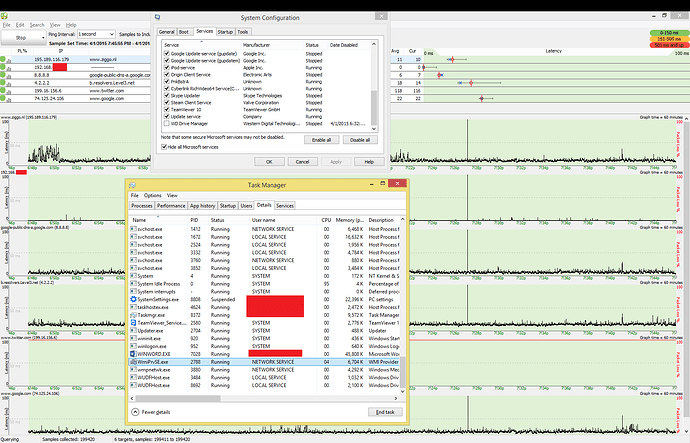

WD Drive Manager Disabled:
To enlarge: Right click → Open image in new tab
On the left of the graphs you can see the bounds of latency, which is 0 to 100 . The only IP coming above 100 is Twitter.com (not sure why, but this one always has a ping of 120-140, on all other devices i tested). But none of the other IP’s are coming above 100 in the last hour.

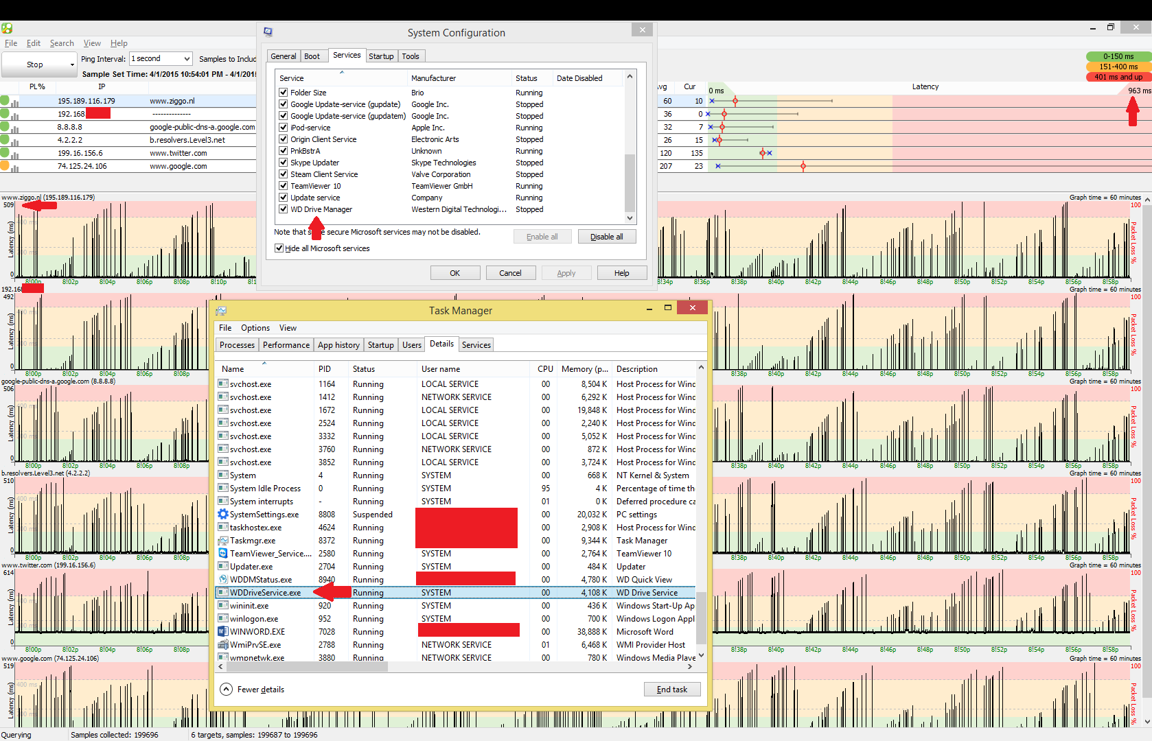

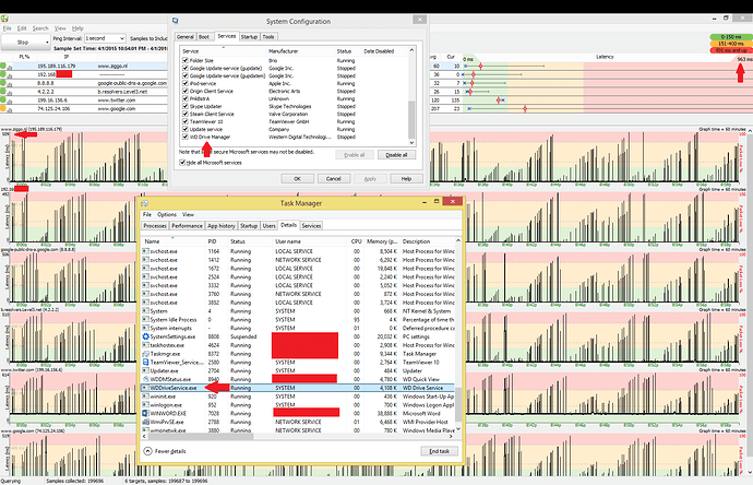

WD Drive Manager Enabled:
I turned on the WD Drive Manager for an hour to show you the ping spikes. On the left you can now see the graphs bounds are from 0 - 510
Also the Latency in the top right corner is showing pings up in the 800-1000ms
