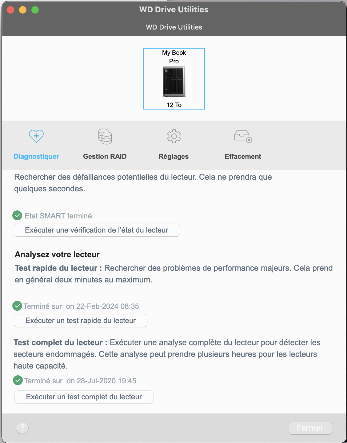

This is where I encounter a problem :thinking:. If both the two new 6Tb HDD are well accepted by the My Book Pro, showing an icon wit 12Tb in the WD Drive Utility software, the maximum capacity I can enter is still only
 3Tb!

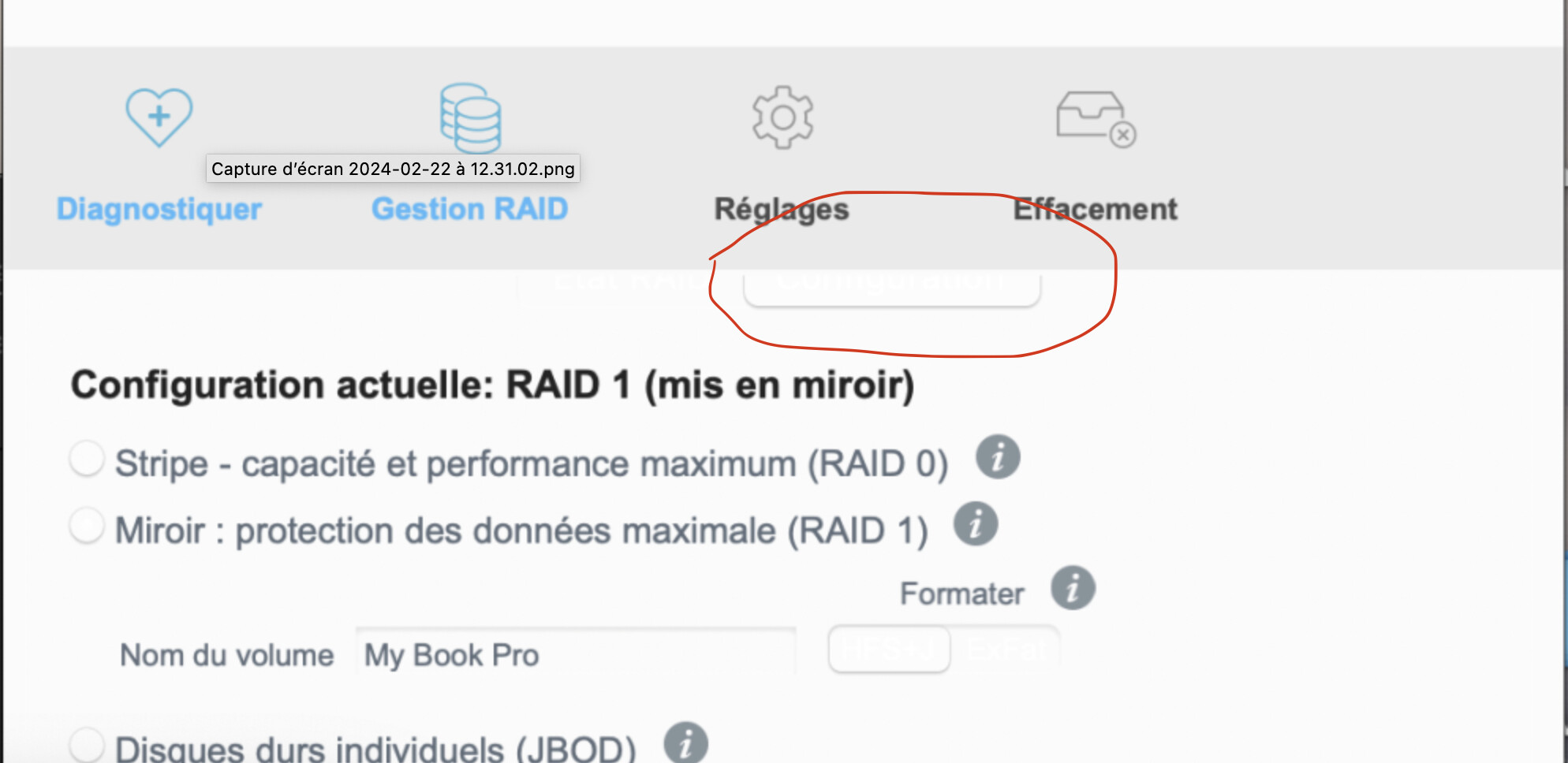

OK. I finally solved the problem.
After a close and long examination, I discovered a white (on white background) “button” under the grey banner of the WD DRIVE UTILITIES software. I have been looking for this function without success. Then I looked to an older version of this software to see the position of this button and this helped me to find it at last!
From there, I clicked on RAID MANAGEMENT and I was able to reinitialize the 2 6Tb HDD by erasing and reinitialize them in RAID O and JBOD (individual hard disc). And I checked with my Imac disc utility that both were now 6Tb.
Then I switched again under RAID 1! And again I checked that the visible HDD was still 6Tb.
Now it seems to work perfectly.

So to make a long story short, you can upgrade a Western Digital My Book Pro to 6, 8, 12 or 16To (16To being the maximum). I upgraded mine from 6 to 12To and it works perfectly well.
