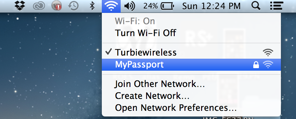

Trying to set up My Passport Wireless & network is locked/needs passwords
I just got a My Passport Wireless, & I am trying to connect it to my Mac Book Pro. It shows up on my networks, but it is locked & requires a WPA2 password. This is brand new, out of the box, so why does it already have a password on it? I am stuck & don’t know what to do!

Yes, I’ve read through the User’s Manual & watched the video tutorials. But right off from the get go, when I try to connect to either my phone or my computer, it says I need a password, which is why I’m confused because I haven’t even got to the setup process to create my own password.
Agree, something is not right. You should be greeted with the setup procedure. So, you need to reset your MPW to factory defaults. I have done this many times for various reasons. It does not delete any data, it just resets the MPW like it was out of the box, so you can set it up from the beginning and put in your password, etc.

Are you sure you don’t have the My Passport Wireless PRO? It has a password out of the box, and it’s printed on a sticker.
Good point, Tony!
