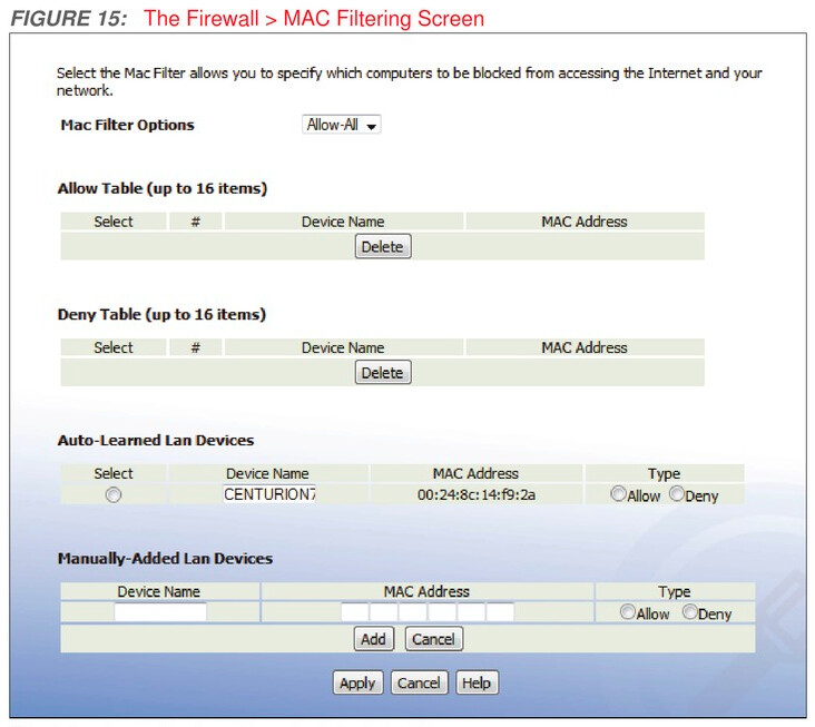

For my router I find the option MAC filtering,
Blockquote
you can set up a list of MAC addresses, and then specify whether Deny/Allow the devices on the list access to the CVE-30360 and the network (in which case all other devices can access the network)

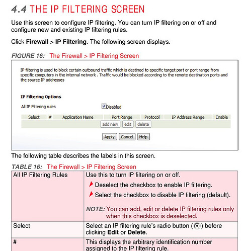

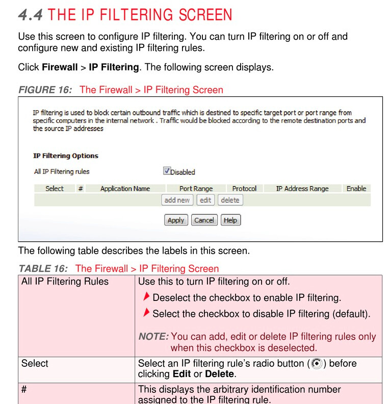

Or maybe the feature IP Filtering:
Is that the same?
You may want to contact your broadband provider or the modem/router/gateway manufacturer for assistance with that device. As previously indicated not all modem/router/gateway units will have a clear cut option to block broadband access to/from a specific network client device.
Generally MAC Filtering is used to block or allow specific network clients to join the local network (or WiFi connection). It typically either allows the device on the network or it doesn’t. If it doesn’t allow the device on the network then no other devices can access that MAC Filtered device.
No idea if IP Filtering could be jury rigged to block all the ports (generally 0 to 65535) for a specific network client and if it would block both inbound and outbound connections. From the sounds of it, based on that screen capture, that router/gateway may only bock outbound connections. Better than nothing but its better to block both inbound and outbound connections, if possible, to the My Cloud.
do you mean, that if I block the MAC address of the MyCloud on the router then I wont be able to access the Mycloud at all?
Usually MAC Address Filtering bocks or allows specific devices from the local network (and by extension broadband/internet). See the explanation for MAC Address Filtering that the user manual for the Hitron CVE 30360 gives. (English User Manual or Spanish User Manual)

yes, and that is what one wants/needs to secury its MyCloud, right or not?
No. The user manual indicates by using MAC Address filtering, one is either allowing individual device access to the CVE-30360 and the network or disallowing individual device access to the CVE-30360 and the network. If the device cannot access the CVE-30360 or the network, how can other local network devices access that device that is being blocked by the CVE-3036?
